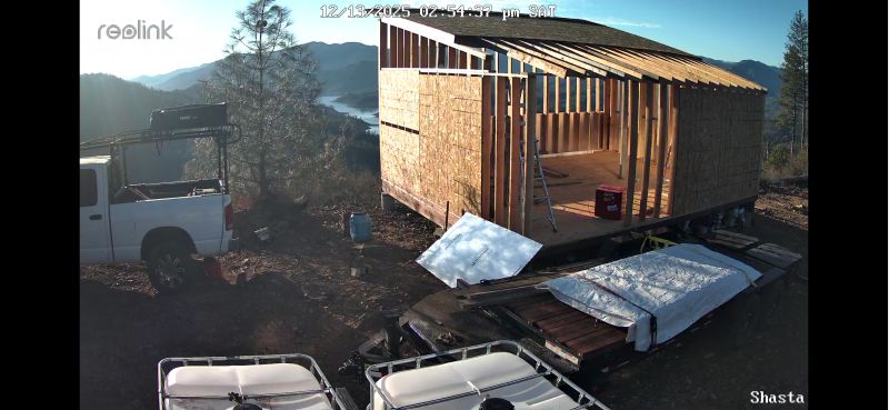

Hi- up in NorCal building our dream off grid cabin - bought a kit on Amazon but was wondering if I route roof water into a vertical 4” pipe with say a 5/16 drain hole in the bottom and a leave filter - the first run off will fill the pipe and slowly start dripping and the over flow will fill our tanks. When the rain stops the abs pipe empties via 5/16 hole and resets. On next rain it again traps the first gallon or two before overflowing to tanks.
Thoughts?
