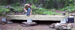

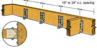

![Small Cabin Floor Frame Construction - Nailing Picture](pic/small-cabin-build-floor-frame-nail.jpg)
The
outside perimeter dimensions of your small cabin floor frame need to be exact in the size of your choosing (for example, 8x12 ft). It means you need to cut joists to their proper length before nailing the floor frame together (for example, 8 ft less 2*1.5 = 7' 9").
Construct the floor frame of your small cabin by nailing joists together with joist hangers.
