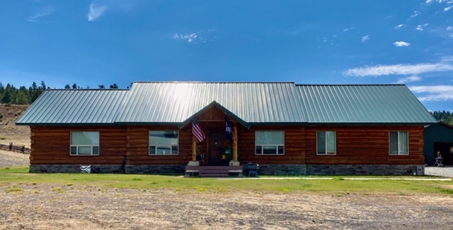

My Son in law used an Alaska mill with a big (not sure of CC, but my guess is 60-70cc and 30" bar) saw to 3 side all his house logs. I helped lay up about half the house (30x55' house, single story) and though it seemed like a bit of a trick to lay out the straight edge track, esp for the first cut.... the saw went through the dead, dry tamarack (western larch for the purests!) like butter. He made some really good looking 3 sided logs.
The key seemed to be a big enough saw and precisely laying out that first cut.

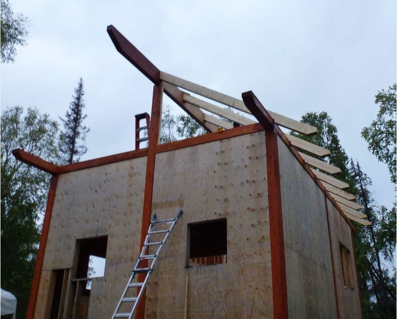

The 8x8 stained timbers in this photo I milled with an Alaskan chainsaw mill from trees on our property. It was a LOT of work and slow going. The 8x6 rafters I bought from a sawmill and hauled in with snowmobiles.

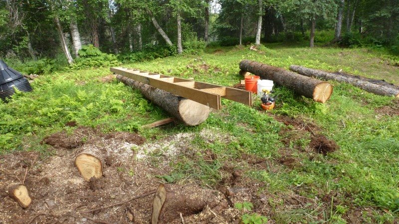

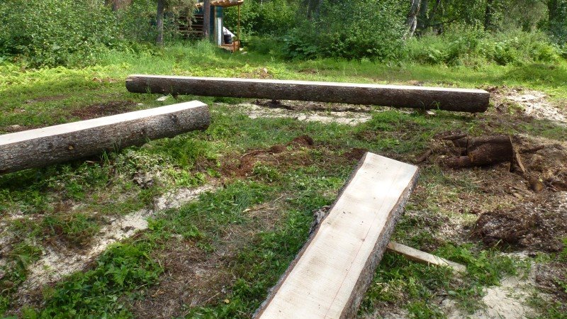

Yes, you want that first one flat because the rest of the cuts use that surface. I made plywood "ladders" to place on top of the logs. I made three 8' long ones that could be bolted together. Some of my timbers were over 20' long.
I started with a Stihl 361 and quickly changed to skip chain to keep from over loading it. I eventually bought a Stihl 660 that works much better.

Pretty hard for a soft wood... li,e pine, fir, etc.... from the net: "The wood of the larch ranks as one of the strongest among softwoods. And at 39 pounds per cubic foot air-dry, it's as heavy as many hardwoods."
Yes a bandsaw would be great... I'd love to have one as I'm sure my son in law would have... cost is a factor and an Alaska mill is way cheaper and if used correctly makes good wood.
He would mill 5-6 each evening and we would put them up the next day. I helped for a month and we got to about the 5' level. He was setting trusses in about 2 months after starting the log work. It is a pretty big home... radiant floor heat with a wood fired boiler out back...nice!

Wow beautiful home!
