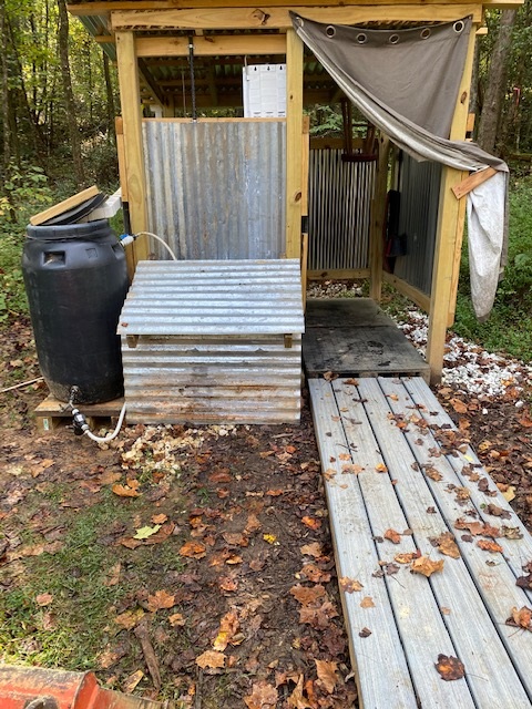

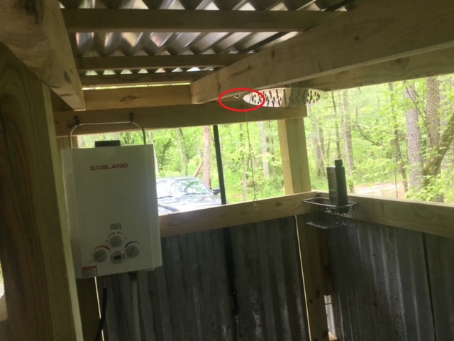

I just had to put a new one on our camp shower this weekend. I used a 5.3 gpm. It is only for our shower and because the 55 gal barrel is outside in night temp of 35, you have to use the propane heater's flow control to slow the flow down enough to get it in the 101-108 degree zone. When its get colder, I will switch to our 20 gallon barrel and have to recirculate it to get it up to those temps.

My thinkin is that no matter how oversized a pump might be it can only flow so many gph though the unit at a given pressure but you may need to be using a pressure tank rather than just a pump inline; ie, keep the pressure reasonable for that 55 gal. and be good for a lot of use IF you do the fancy version of a 'Navy shower'.
We have this shower set up:
https://www.amazon.com/gp/product/B000UD7D7K/ref=ppx_yo_dt_b_search_asin_title?ie=UTF 8&psc=1
55 gal will last 4 folks a long weekend with them taking 1 shower a day navy style

# Posted: 2 Nov 2020 11:45am
Ok that's good to know. What kind of pump did you use? How high is the water being lifted? I'm trying to get a sense of how much the flow drops with height. Thanks

mj1angier
# Posted: 2 Nov 2020 04:05pm
Quoting: KevinA
This is the pump:
https://www.ruralking.com/catalog/product/view/id/23989
We are off grid so 12 volt pump was needed
The 55 gal barrel is just on the other side of the tin wall on the ground
