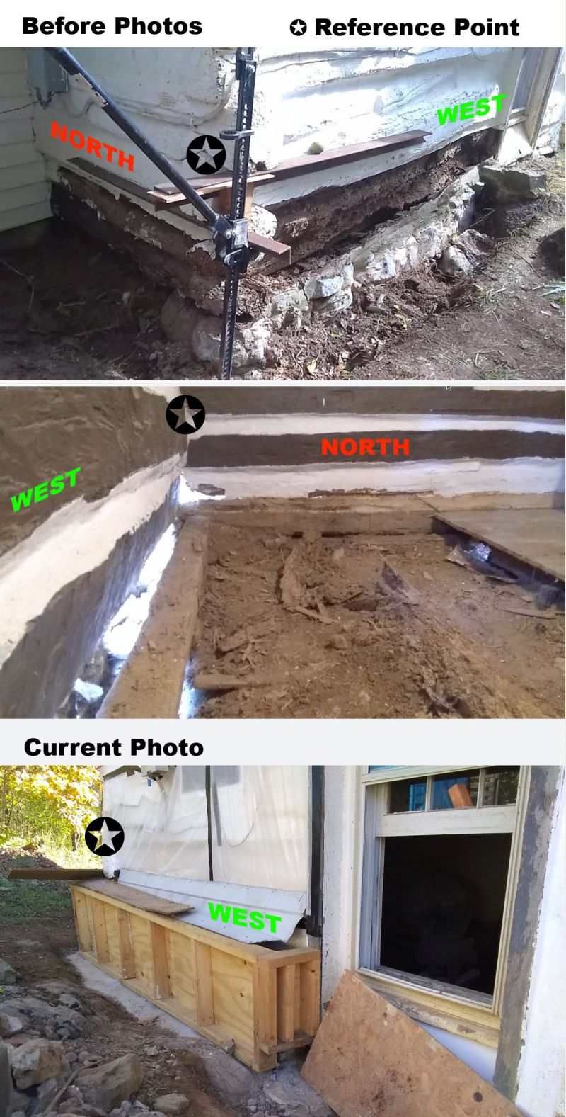

Our family farm has a scenic log cabin/guest house that needs help and I'm concerned that if we do things backwards that moisture will soon lead to mold.   Would you be so kind, using prior experience when possible, to steer us and lead us forward.
Our cabin we’ve discovered is not original, it was probably a former barn that was trucked in and reassembled into a fishing cabin along the creekside in the 1940’s. It sits on a 15 degree slope, and has a very minimal foundation, and the backside logs touching the earth have rotted out due to poor rain water drainage. The bottom logs are 75-80% rotted out. The original plan was to “en-tomb” the rotted logs in concrete on the outside and underside leaving the interior log facing “as is” for cosmetics.

At this very moment, and the clock is ticking because the concrete truck will be showing up soon, the lead on this project has reverted back to the original “entombing” the rotted logs in concrete. To prevent moisture, from weather fluctuations, it has been decided TO COAT THE DAMAGED LOGS IN TAR FIRST. So, is this tar and concrete plan acceptable ?

I wouldn’t do it like that unless you are using this as a temporary fix to buy a little time .Concrete and lumber don’t mix which leaves the lumber rotten ,the tar will help but the damage is done and those lower logs are junk .I would replace the logs if I liked the cabin ,either by jacking and installingnew logs ,or dismantling the cabin and rebuilding it from the bottom replacing what is required as I went .
Not sure of how you approached the “pro” ,if you
set it up as a temp fix ,or a no budget fix or what , but if that was not said and he suggested this repair he is a complete hack ,probably couldn’t make his own toast in the morning .
If you are trying to do it with no budget ,do the work yourself ,the cost will be minimal ,mostly labour and finding suitable logs .

Brettny... I have a little creed that I live by: "If a job is to begun, never leave it till it's done. Be the labor great or small, do it well or not at all". It's not about turning back, for me it's about doing it right.
Bruces... The restoration pro's advice: "To replace kind with same kind" His advice is to replace the logs with oak or locust logs. I have 3 lumber mills waiting for me to give them specifics. Also air flow and ventilation was of utmost importance.

That makes a lot more sense .The pro is right .Since you wish to do it right ,call a full stop to the lazy mans disaster already started ,and come up with your own plan to properly replace the logs .If your mom still wants to drag in a new box ,it might be a great time to dismantle the old cabin ,and do the entire thing right .I am hoping you have room for both cabins in the end .

If you want to do it correctly I would replace any rotted wood and re grade behind the place so any wood stays high and dry. If the rain goes off the roof at the back side add a gutter and piping to get it away from the building.
Concrete is not waterproof and wood shouldn't be on concrete even if its PT. Separation of the two and allowing anything that's possibly going to get wet to dry will make it last longer.
Adding a big water catching shelf on the back isnt going to do you any favors. I have one on my house and had to replace alot of rim board prior to flashing and siding. You cant do that with a log building very easily.
