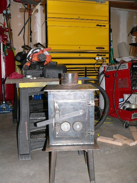

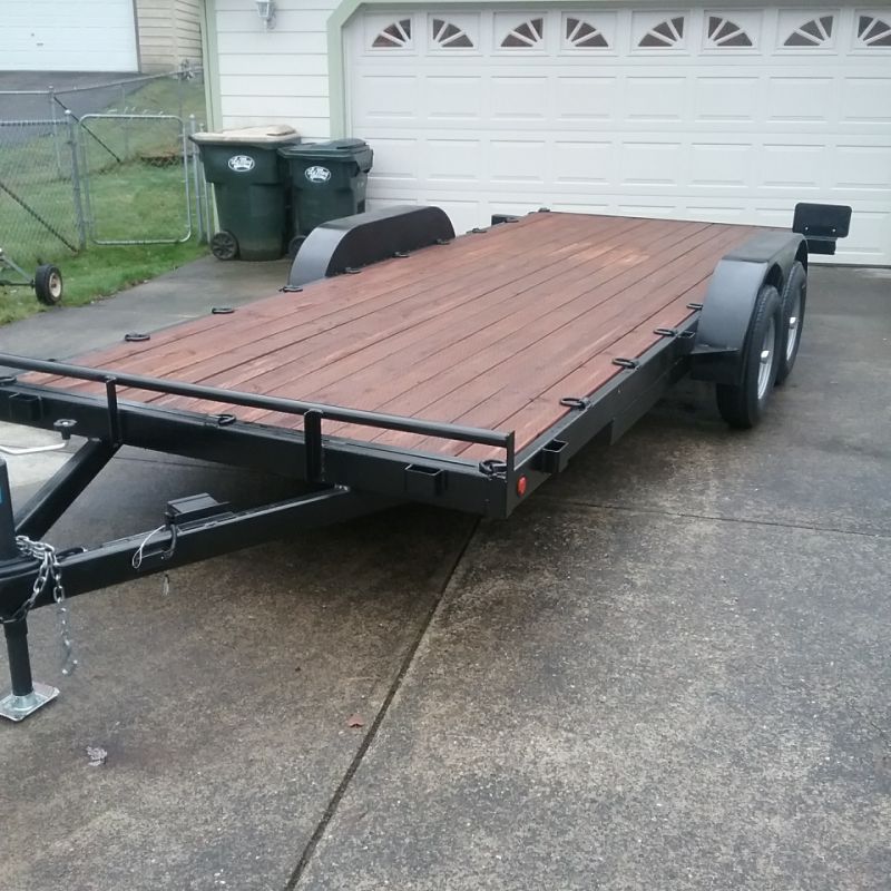

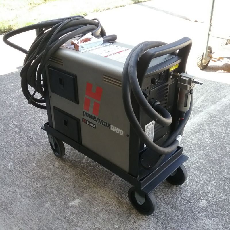

I built woodstove for my cabin, trailer for a buddy, plus I make anything I need that cant be purchased like a roll cart for my plasma cart. I glued one up in under an hour after my 4 casters came in from amazon.
Oh, Willie, get an auto darkening helmet, best thing since sliced bread and make sure you have no exposed skin when welding. You will get radiation burns, cover your arms etc. If you are like me and wear short sleeve shirts, I have a set of Lincoln welding sleeves I put over my arms. The red welding gloves from Home Depot are top notch, nice and soft from the get go, the gray Lincoln ones are stiff.
See wodstove I made (welder in background, its on a cart, makes it easier to operate)
Plasma cutter cart
trailer I made in 5 weekends.
