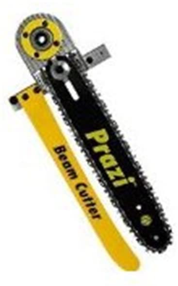

# Posted: 22 Nov 2020 09:47pm - Edited by: Nobadays
This might be a cheaper way to go... I think this is what our local D log builder uses. Prazi Beam Cutter
doglvr
# Posted: 24 Nov 2020 02:08am
Nowbadays......That's perfect. Just watched some youtube videos and this looks like it will work great. Much appreciated!
