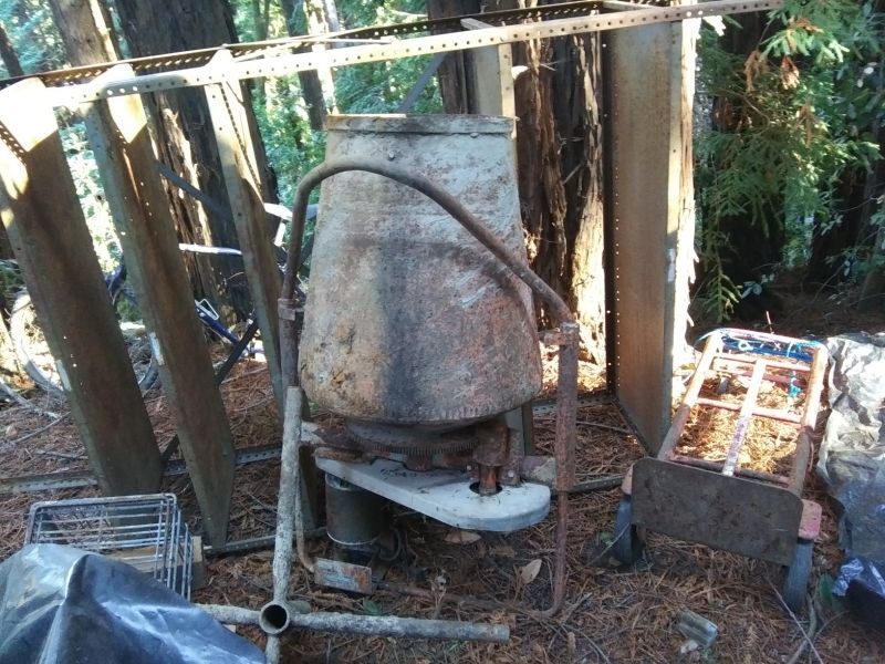

Doing the last of the behind the shed cleanup and drug out this cement mixer I have never had a chance to use. Been sitting back there a few years and now rusted frozen but I'm sure I could get it going again.
The question is, is it worth it? I may do a retaining wall next year. Do you buy the materials separate or just put ready mix in and save the wheelbarrow shovel mixing routine?

Well I can tell you I spent a summer on the construction job as laborer that made and deliver the concrete around. Boy did it suck. Nothing but heavy lifting and back breaking work. However that year in football I was a total animal on the line.
Since then I've had two cement mixers. Gave one away and made the other into a planter.
It is cheaper than delivery of a mixed load. If it's the only way to get concrete there well. But you'll be surprised how many bags of Portland cement, sand and gravel you will use to make a wheelbarrow load.
However, It is far superior than trying to mix it by shovel

1 or 2 bags is fine to mix by hand after that I use my electric mixer. Anything 3cuyrd I order and they deliver.
What do you plan on making a retaining wall out of? Block or a complete poured wall?

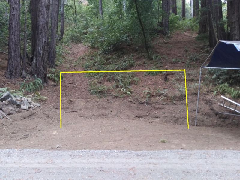

Quoting: Brettny What do you plan on making a retaining wall out of? Block or a complete poured wall?
I want to cut back into this hillside for a parking spot, maybe even a carport. Maybe 6' tall wall, 15-20 wide. Blocks with rebar would be easiest, if it would be strong enough.
# Posted: 3 Dec 2020 05:50am
I would use a block made for retaining walls. At 6ft you will need it. A vertical mortared block wall can be pretty weak or even move if theres any water pressure against the back. Most retaining wall blocks step each block back to add to the strength.
I would avoid any wall if you can. More infrastructure just means more to take care of. Can you just dig back and make a swale at the bottom to move water away?

Thanks guys. Well it's not on the docket until next spring at the earliest. As Brett suggests, I may be able to dig back far enough to not need a wall. Probably depend on the tree roots. Mainly just wondering what to do with this mixer. I like the planter idea..
I do have enough leftover 2" thick redwood boards I milled, maybe for a shorter wall.
