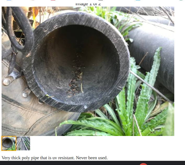

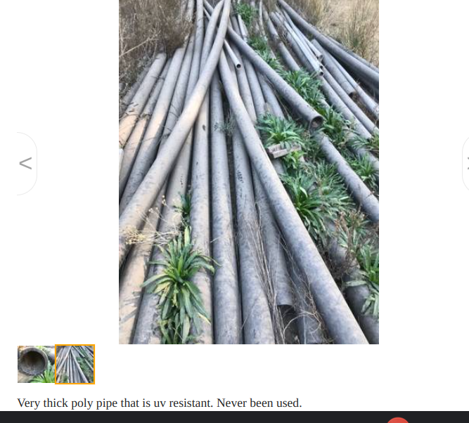

Guy in my town is giving away all this pipe. Any idea what it is and is used for? I think it's 3". Too thick for regular ABS looks like.

Looks like a heavier sch ABS than your typical plumbing pipe.

If it is somewhat flexible it might be a polyethylene.... usually heat welded together. I don't know if there are fittings for it. Usually used for long distance above ground runs. Temporary piping...

The ad says 'poly pipe' (bottom of photo) and it does look somewhat flexible. Yeah regular ABS couplings won't fit..
It was on CL about a month ago for a buck a stick, I emailed him for diameter, he said 3 inch maybe but would measure. Never got back to me. Now it's free.
I need 100' of 3" ABS for my drain but not going to weld this stuff to save a few bucks.

Looks like HDPE pipe which needs to be fused. If you want to use for drainage you probably could outside. If it is IPS pipe schedule 40 fittings will fit but you would need some type of epoxy to glue it, PCs glue won’t work. If it is CTS size you would need to fuse it or use brass compression fittings which would be cost prohibitive

You need to get the info off the side of the pipe to be sure

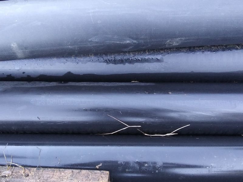

Just got back, he's right down the road*. Really hard to read the writing on the pipe, 4" IPS DR11 Driscolex something. I was going to put it on my rack but they are 30' sticks! About 25. Going back with a trailer tomorrow. He's getting rid of a bunch of pipe and junk, I took a few things in my truck.

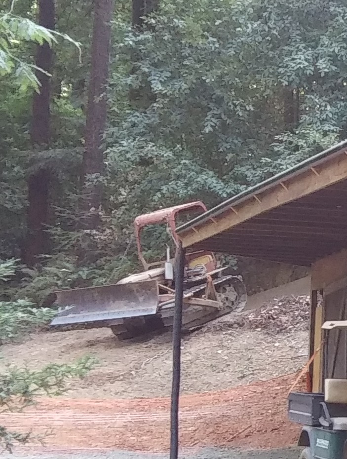

* So way back about 8-10 years ago, before I built the cabin, I was driving to the property and noticed some piles of road base, which I was needing, in front of a property a few driveways down. I stopped and met the contractor, told him what I was up to. He said there was an old dozer on the property, a 50 acre spread with very nice house, barns.., the owner was an old guy who was not well, and I was welcome to the dozer. I grabbed it, got it going with a bit of work and have been using it ever since.
The owner died and left the property to his accountant, much to the dismay of his family. That's about all I knew until today, when I met the kid, the son of the accountant, who is trying to clean the place up. The pipe is sitting not 20' from where I picked up the dozer years ago! Small world.

Nice! IPS will be easier to find fittings to make work without fusing.

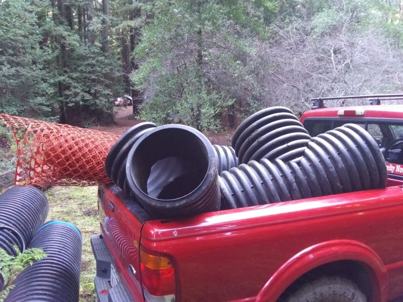

# Posted: 23 Dec 2020 10:06am

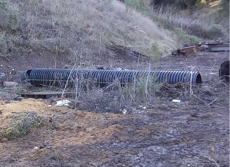

Heck, I would do it for the double wall pipe alone!

Read about Drisco pipe history above link.
I've used thousands of feet of such HD poly pipe for o&g flowlines for the past 40 years, great stuff. The original orange pipe wasn't resistant to UV light & would become hard and decompose over time when left exposed. But when Phillips Petrol. & Depont developed this product it revolutionized the "fast-pipe" industry.

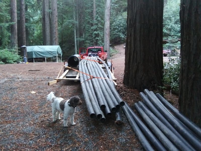

# Posted: 23 Dec 2020 04:22pm
You bet I'm gonna read about it, now that I officially have some..

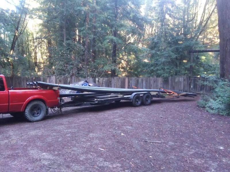

Phew, that was the craziest thing I have towed in here. These suckers are 40'! And about as stiff as a wet noodle, which is actually perfect for my project. I extended my trailer this morning planning on 30 footer. Took some doing but got the first half of them here. Going back later for the rest, should go easier. Like I said, they are literally 1/2 mile away, I went about 25 mph. Zero tongue weight.
Wonder how much these these are worth? If I'm saving a hundred bucks I'll kick my own ass. Well, gotta unload and go back.
# Posted: 23 Dec 2020 04:27pm
well I'm glad you made it back safe. that is quite the transport method.
# Posted: 24 Dec 2020 07:49am
Second round went quicker. Little over 800'. I only need 200 for my drain, 5 pipes, so I think I'll just use the rubber clamp couplers.
Thanks for giving me the impetus to go get this stuff.

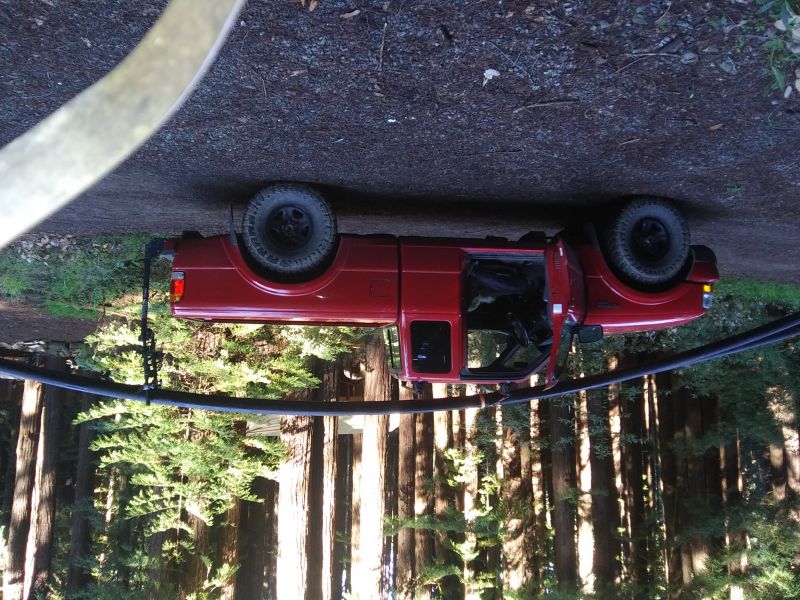

# Posted: 20 Jan 2022 03:25pm - Edited by: paulz
Finally getting around to using some of this stuff. Have to haul it up to the cabin from the yard, 40' sticks. Damn stuff is heavy 1/4" wall, too long and heavy to hand lug. So this is my makeshift rack. The front are ski racks, the back is a hitch mounted bike rack turned upwards. Got them both at a rummage sale for five bucks. I didn't want a lumber rack on this truck, cabin is done, shop is done, still going to do a tractor port but the materials are already here.
Dammit, picture flipped..

# Posted: 23 Jan 2022 11:58pm
I love the ingenuity! Never pass up some good free stuff - those are the words I live by! I have access to a pretty amazing industrial dumpster at my work (3 actually). I've found anything from Knack boxes, a welding table, scrap steel (I once got a sheet (6'x9') of 1/8th steel plate outta there!), dimensional lumber, wire and more in there!
I know it was awhile ago - but that culvert you snagged was worth the trip alone! That stuff is gold around these parts.

I'll be using that culvert pipe too at some point!
