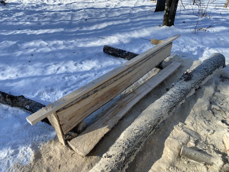

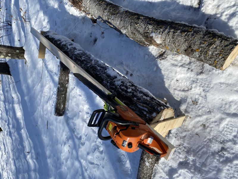

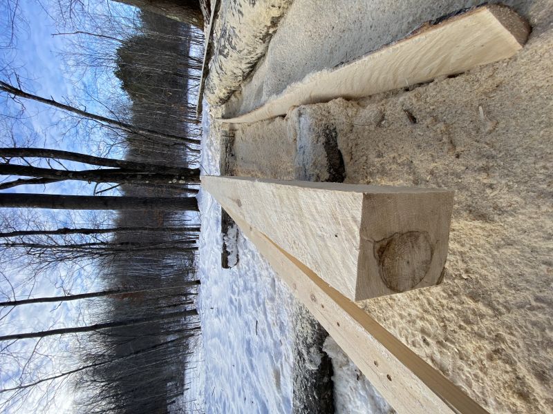

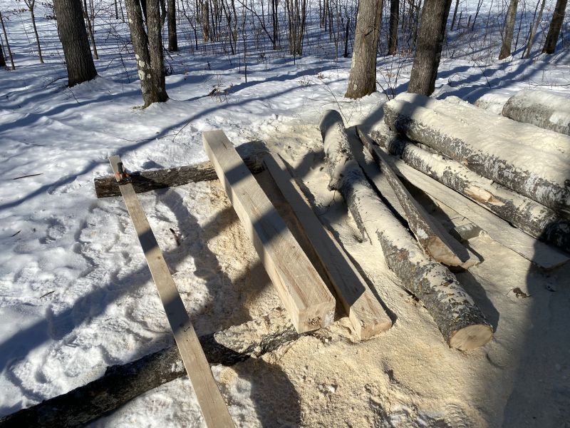

So i got 2 beams, a 4x6 and 6x6 both around 8-9ft long. Each cut took around 10mins and about 2 tanks of gas per beam...so about an hour per beam.
One of the big complaints of this mill is the set screws that tighten on the bar come loose or fall out. I never had that issue once. On initial setup i lightly snugged each one down and then went back through a couple times tightening each one a little more. After cutting each side of the beam i would check them again keeping the allen wrench handy in my pocket. The kit does come with the option of drilling your bar to run bolts through it, and i may consider this in the future.

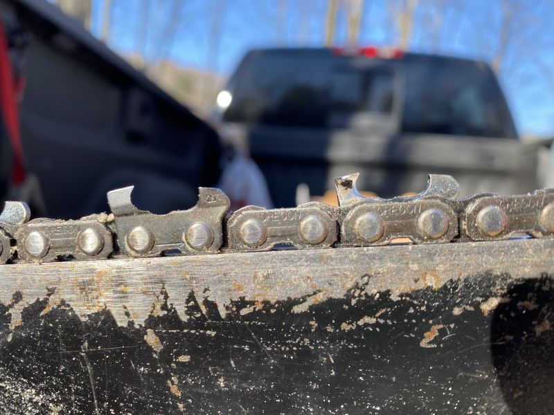

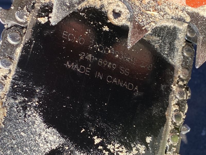

Attached are some photos of my current bar/chain. Let me know if the link you sent is still the correct one.
When you discover this is when things go wrong, perhaps very wrong, and maybe dangerous.
Yeah, there are alot of photos and vids where the set screws come loose and either the chain gets trashed or the U shaped clamp of the Timber Tuff breaks.
# Posted: 26 Jan 2021 08:16am - Edited by: toyota_mdt_tech
I'm sure it is. I suspect you have a 3/8 chain, in fact, I see 3/8 on the bar. It looks like you have the semi chisel chain which is real common. Remove the chain and count your drivers, those are the hooks that ride in the bar, a 24" bar usually have 84 drivers.
And when your not ripping and want to really get after firewood (crosscutting), grab the Oregon 72EXL084G, this is a chisel bit chain, non safety chain (code red) and its a mean unit.
Yours looks like its at the end of its life now. I'm certain its .050 gauge
