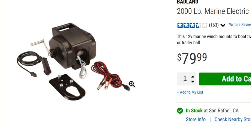

Only time I've had this predicament I made a cart with bicycle wheels and hauled it up with one of these winches using a stake in the ground and a car battery. Slow going but the only thing that got tired was my thumb on the switch.

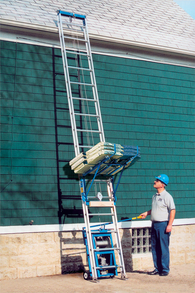

How about a shingle lifter for the stairs then a sled and winch for the trail. You can buy/ rent/ build them cheaper than messing up your back lol
Shingle lifter
Shingle lifter

Those shingle lifts are absolutely great for roofing jobs. It's like having your own elevator. Tar paper, ice and water shield, shingles, nails and tools all take a ride and dont need to get carried up. Il never do another sizable shingle job without one. Bu you cant really lay them down and use them on a hill. There not really made like that.

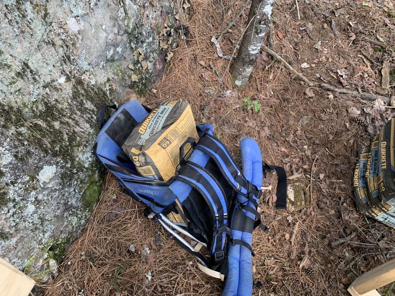

100% Kid hiking backpack- or rather a backpack for carrying your kids while hiking. It has a framed opening where the kid a.k.a concrete bag goes.
I did this. The backpack saved my you know what. 50+ 60# bags of concrete up a 50’ incline “goatpath” 400 feet back from the water.
Started by shouldering it and getting covered in concrete dust. Then had a though about our hiking pack that we no longer needed since kids are a bit too old for it.
Absolutely works.
I put a nail in a tree. Hung the backpack on the nail straps out, lifted the bag and put it, then backed up to the hanging pack and strapped in.
Easy compared to alternatives
