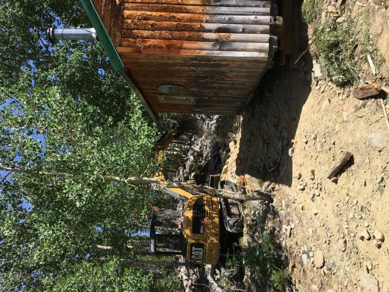

I had to move our small little cabin because of our big cabin. I made a pad back in the aspens for it.
I have a 12ton Mini Ex with 6k of lifting capacity and it could barely lift one end of the cabin up about 6 inches. That was enough. It's 10x15 and had to weight close to 6 tons. I used 6 ton floor jacks put under the skids to put oil field pipe to roll. I also had to use a 30 ton chain winch to pull it back to where we wanted it. It was quite an undertaking to move the little thing, but it was worth it.
