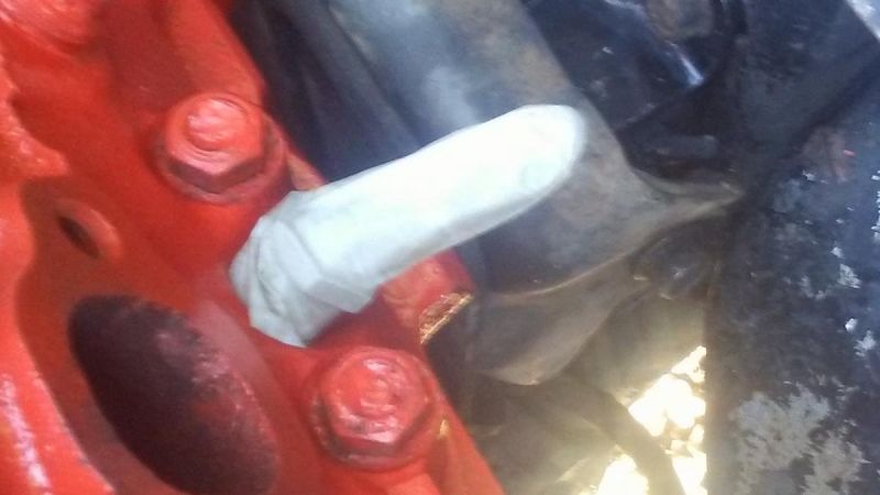

# Posted: 18 Apr 2021 01:52pm - Edited by: paulz
Quoting: Nobadays
Just have to figure out how to tell when #1 is tdc. Plugs are way down in there but I'm thinking a long screw driver on top of the piston.
Here's what I do: knock the center out of an old plug, stick a finger off a neoprene glove over it. Inflates fully at TDC. Deflates quickly before and after.
Course if your plug holes are dead center in the top of the head you can just 'poke a spoke' as we say in the motorcycle world.
# Posted: 18 Apr 2021 02:50pm
Neat idea! Now if I just had a neoprene glove.... sometimes living an hour and a half from town, 22 miles of which is nasty dirt road has disadvantages.
Plugs are on the side'ish but I think I can stick something in there, maybe a piece of electrical wire as I don't have a spoke either.
I've been stressing over this to the point my stomach is in a knot... I don't like troubleshooting vehicles, I'm not good at it. We'll play around with it tomorrow and if I can't figure it out.... it's going to town.
# Posted: 18 Apr 2021 06:25pm - Edited by: paulz
A condom works.
The few timing belts I've done, the crank pulley has location marks, no need to find TDC. The cam pulley mark will either be in it's required spot or 180 degrees out, in which case turn the crank one turn and it should be correct. Cam turns at half crank speed.
