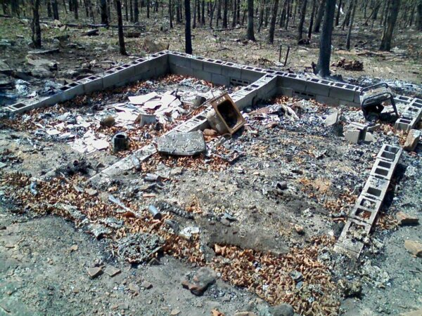

unixfmike
# Posted: 1 May 2011 20:07
I didn't even consider it. Then it was too late.
--MikeW
