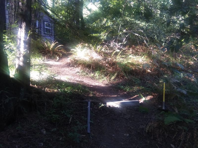

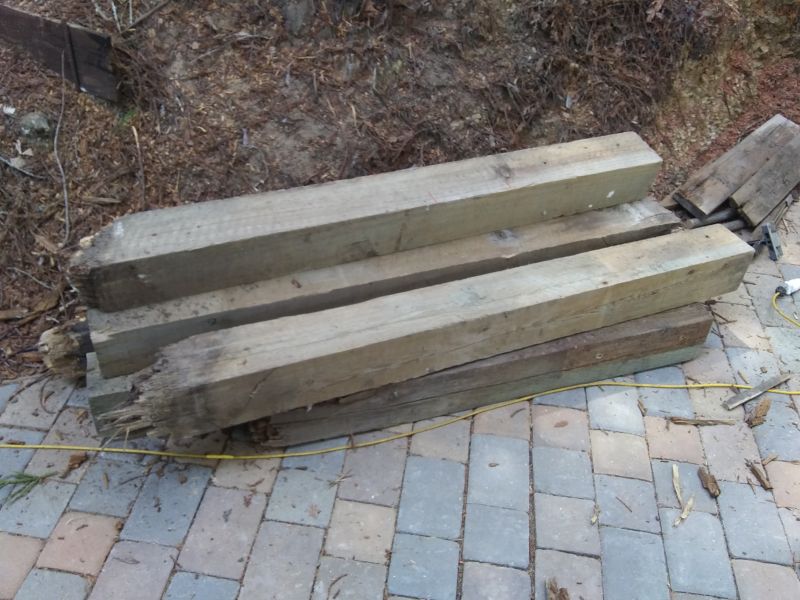

As I mentioned yesterday, I've got these used 6x6s just given me, and my plan is to make dirt stairs up to a shed. Want to figure it out right, pick and shovel takes it's toll on the old bod. If done right it shouldn't be too bad..
So, in general, more important to make the top of each step level with the bottom of step ahead of it, rather than worry about the spacing between steps? I figure I'll put the boards halfway in the ground and use the dirt I dig up to back fill to the step below.
Any advice? Any volunteers? It's a beautiful day..

I'll be cutting those posts in half, to about 28", so more like 14 pieces but yeah, probably 15' of rise or so. I do have some old 2x6PT I could nail together..

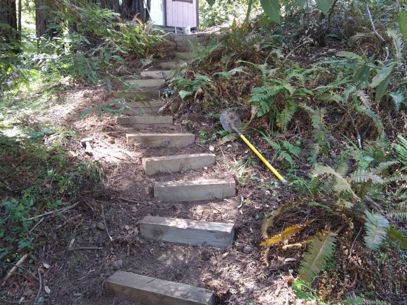

Roughed in, still jockeying them around. Once they're settled in I'll drill and stake with rebar. Only I and the dog go up there, and so far he's going around (he's familiar with my work) so no rush.
Wasn't a project I was planning on but when the free posts came along I didn't want to have to store them. And I have slid on my butt several times going down previously so worth doing.

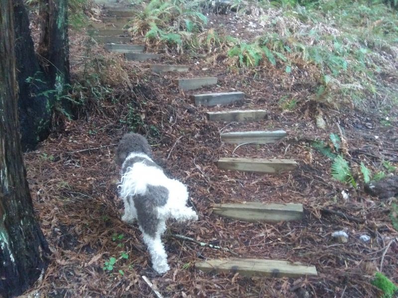

These are about a step and a half.
I tried measuring, calculating, but in the end the hill is not an even slope, steep at bottom, flatter in the middle and steep again at top, so the run has to vary to keep the 6" rise even.
Going up one step no problem, going down, especially carrying something, yeah, two steps.

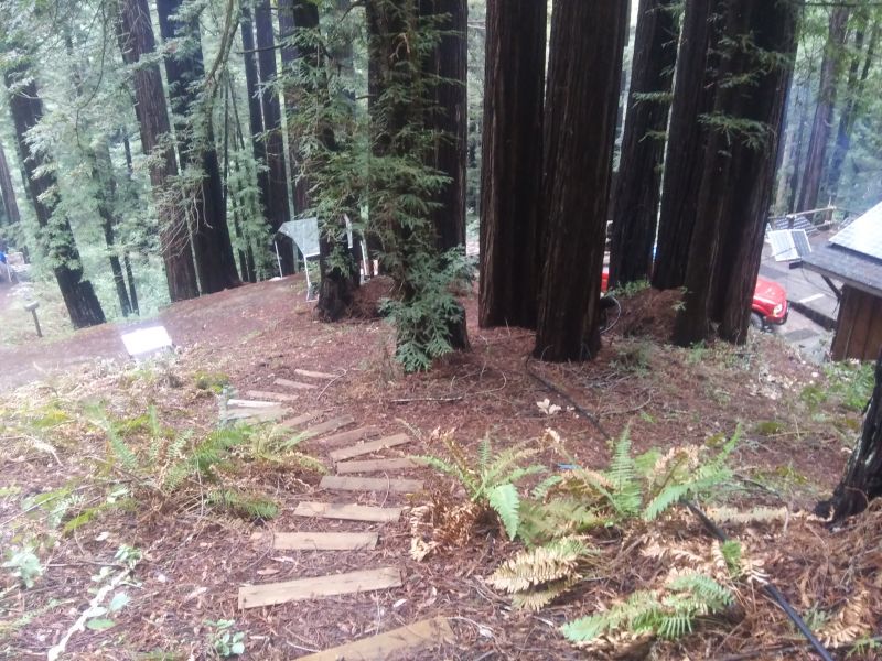

Sure am glad I got these in, been up and down them 50 times in the last week putting solar panels above the cabin. I haven't spiked them in but they've taken a pretty good set in the wet ground.
Buddy appreciates them too.

I have used steps in dirt made from 6x6 that had a run of roughly 2ft and front to back where level. Man where they terrible to walk on. You non level front to back treads look way easier to walk.
# Posted: 23 Dec 2021 09:13am
Yes I have walked those long run/short rise stairs on hiking trails, one footstep flat, next one up. Not much else you can do on low slopes I guess.
I had hoped to use level front to back but with a slope around 100% they would have been right next to each other. Railroad ties might have worked that way, these were old fence posts a friend gave me. They are a bit hap hazard with the varying slope and curves but easily negotiable. Better than sliding down on rump as I did several times prior.
