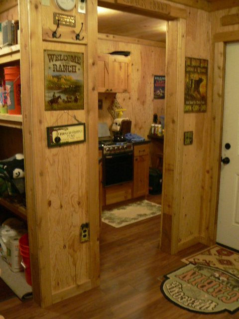

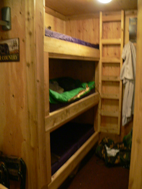

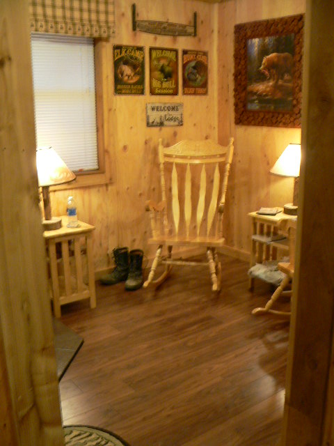

# Posted: 1 Jun 2021 09:00pm - Edited by: toyota_mdt_tech
Quoting: Myoldhomefallsapart
I want some walls with pine-knot-showing wood like in the Amish cabins. However, some I want to paint, like dark in contrast.
I wonder what would be the most economic solution.
I used 3/8 plywood, sand the stamp off. Plywood isnt cheap now, but it was then.
Sheetrock in the 12 footers laid on its side is a breeze, get a rotozip spiral saw, get the flush trim bits made for sheetrock and grab a sheetrock jack for doing the ceiling. With that and one of those ridgid screw guns that use the collated screws, makes drywalling a breeze and the 12 footers on its side makes it a dream putting in place.

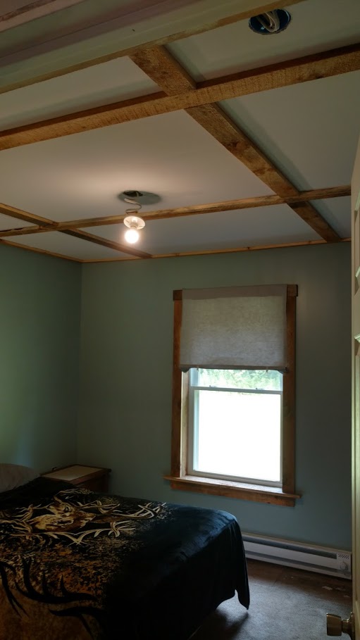

jsahara24
# Posted: 2 Jun 2021 12:49pm
While I am not a fan of it, you could always go with a textured finish on the drywall to hide the imperfections..... Mudding drywall is definitely an art, and I have yet to master it.....haha...
or do a rough tape job on the joints and add wood stripping like I did in my cabin bedroom ceiling....

# Posted: 2 Jun 2021 02:43pm
Thanks for the pic, jasahara. Look fine to me.

jsahara24
# Posted: 2 Jun 2021 04:42pm
Are your walls drywall or plywood? Did you paint them?
They are drywall, I hung, spackled and painted it myself. Best advice I have is many light coats. Now for the ceiling I tend to make a terrible mess dropping the spackle on my head and end up with bumps on all the joints....Hence the rough cut wood strips....haha..
I think it helps give it a cabin feel without having to pay for knotty pine $$$...I did put knotty pine on the ceiling in my main room, expensive but looks great...
# Posted: 2 Jun 2021 09:14pm
toyota_mdt_tech, how did the final result of your 3/8 plywood walls look like after you sanded the print off?
Did you paint the walls? Can one still see that they are plywood walls?
I did not paint it, no one notices its plywood, they just see wood walls in a cabin and it looks normal. I havent sealed it or anything. Once yuor decorations are up, no one notices it. I have way more decorations now then when they pictures were taken.

# Posted: 3 Jun 2021 10:54am
Quoting: toyota_mdt_tech
Thanks for the photos. Looks great!
But it does not look like plywood. Looks like pine-knotted paneling. Where is the plywood? How can you make plywood like pine-knotted paneling? Beats me.
