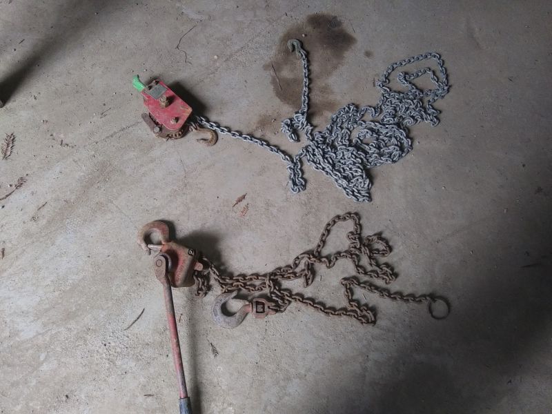

Still organizing stuff in my shop. In addition to a half dozen come alongs, found these that I have never used. Where did I get them? Heck if I know, sure didn't buy them.
I guess they are for vertical pulls mainly? Can they do anything a regular steel cable come along can't? Why would you use one instead?

Stronger and more pulling distance. Also chain is less likely to foul than cable and can be used to grip posts or logs. This is for a start

Thanks Bob. Yes I can see that. I wonder though, without doubling back like the cable on a come along if you get the same pulling power. I have another big one I put up above my gate, just for looks, and it doubles the chain so maybe that has power. It was frozen when I got it, I dunked it in a 5 gallon used oil bucket for a month but probably still stuck.

Doubling the chain means pulling half the distance with twice the pulling power.
