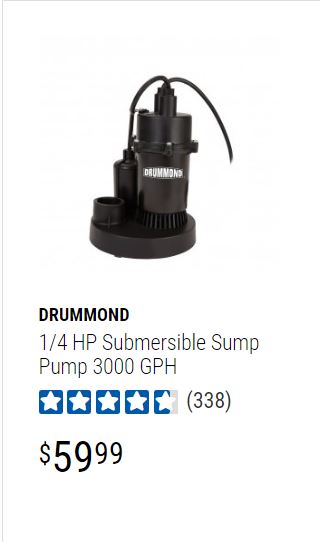

I use one of these to move standing water around my property, using a genny for power. Garden hose screws on and it can sit right in the dirt. My well is also big enough that I've stuck it down there 45' and it pumped water no problem. Had it probably 10 years now, been indestructible.
Never reused the water so haven't done any filtering.

paulz you don't have to worry about dirt getting into those or anything like that?

Quoting: WILL1E
Nope. I used to (back when we had rain on the west coast) stick it right in the mud puddles on my driveway and pump them dry. And my well had 50 years of soot build up at the bottom, I pumped black water for hours getting that out. If the water got too muddy it would slow down, I'd just pick it up, shake it a bit and put it back down.
