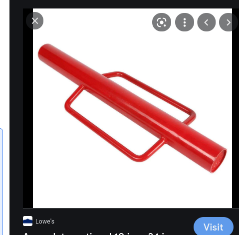

I'm putting up a wire fence using these T posts, and this driver, but man they don't want to go in. I've now cut the bottom 3 corners off diagonally so they form a point, going to try again in the morning.

Yeah, sometimes they are a *#!ch hammering them in manually. Sometimes you can't even get a small skidsteer in place to press them in with the bucket, so the ranch owns a Titan Post Driver. Google it. Very handy. Expensive too. There are cheaper ones but I've never used them.

Fwiw, back on the farm I grew up on, my dad had a local welder make his driver, a real Man-Sized one with a lot of weight. It made me Work At It but also made me plenty strong as a teen! Believe I cursed it more than once....
But Ive wished I had kept it from the estate sale more than once too. Every commercial one Ive looked at is Puny in comparison.
