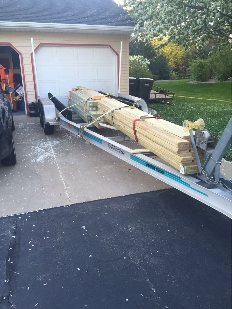

You mean like this?!
Worked like a charm though!

Love the boat trailer wood hauler!

# Posted: 6 Aug 2021 05:29am
That's prob not even close to overloaded for that boat trailer.
WILL1E
# Posted: 6 Aug 2021 07:45am
Nope, no longer have that boat. And no, i wasn't anywhere close. The boat that went on that trailer was a tank! It was an aluminum hulled deck boat we used to have.
