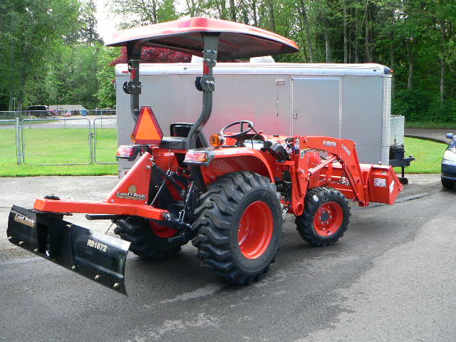

# Posted: 15 Sep 2021 08:04am - Edited by: toyota_mdt_tech
Scott, I did buy a brand new Kubota in 2017, the price was just under 18K with front end loader. I got the L2501. The "L" model is the smallest of the industrial sized units. If you keep it under 26 HP, you get away with no DPF emission garbage.
Mine is hydro-static, and my PTO HP is less by about 1 HP vs the shuttle shift. Hydro is the way to go. I did get a back-blade and sun/rain roof and it was just under 23K out the door, sales tax etc. The good news, all dealers are offering 0 down and 0% interest for 5 years. Mine is a fairly large tractor, pay attention to the PTO HP and what you plan on running with the PTO, they will have specs at to what min PTO HP is needed. The ability for a tractor to do work is based on its weight. My rear tires are also 3/4 filled with beet juice too.
Kubota is the cream of the crop, dealer networks everywhere.
Just delivered, 0 hours

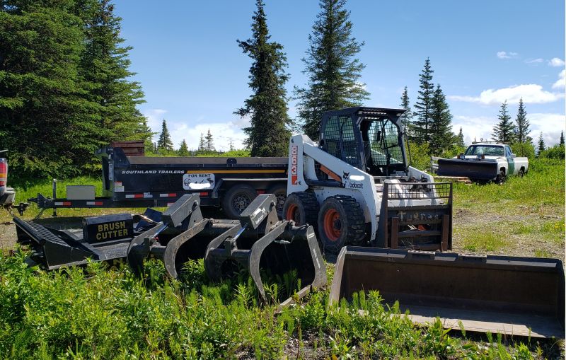

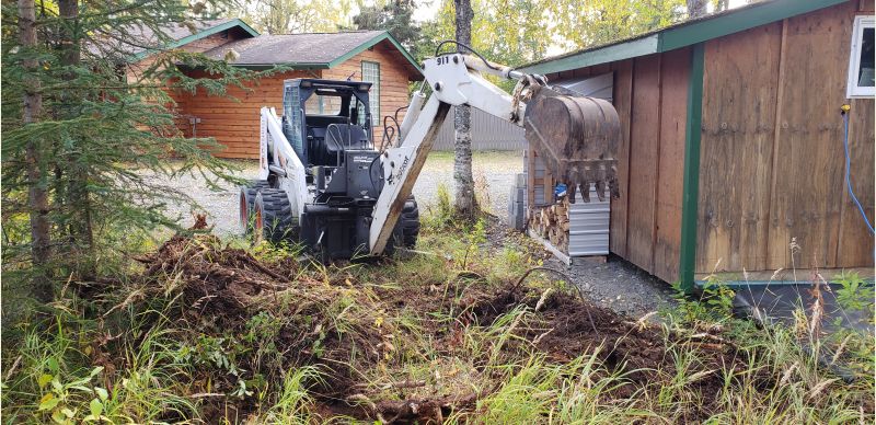

Well i'm glad you have an open mind about it.
Personally in our neck of the wood there isn't much of a logging presence these days, but skidsteers out number tractors 2 to 1. I personally love mine, and the range of attachments I have or can get for it is simply tough to beat.

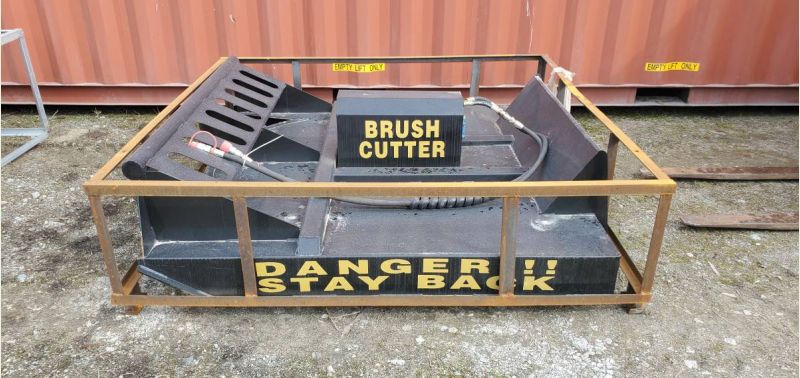

I found a new in the crate brush cutter for $2900 (which would normally be about $5K here), and used it to clear my property for my cabin. I also brushed out the field in front of the cabin we're staying at while we build ours.
Pound for pound I would say I get much more use and versatility out of my skidsteer than my buddies do with their tractors.
While I got a pretty smoking deal on mine, if you look and know what you're looking for - you can still find deals in the same price range you're looking at. For the price range you're looking at, it would need to be a used unit, but i'm sure you could still find a well maintained low-ish hour unit if you're not in a hurry and you have the cash.
I paid $25,000 for my 2000 863 (Non-Turbo) with 1280 hours on it. It came with forks, bucket, grapple, auger with 12 and 8" bits, tiller, landscape rake, 9ft excavator, and stinger. I have since added the brush cutter to the fleet as well.
For my uses, (typically pounding through the woods) the tires are more ideal than the tracks. In terms of trail maintenance I think I could clear twice the land of a tractor in the same time.
Anyways, it may be an idea worth exploring. It has been invaluable while building my cabin this year. I have a few action shots in my project thread if you're interested.
All this to say, a tractor may end up being better suited for you in the end - but a good skiddy with the right implements could give you more overall versatility. I wouldn't blame you for going either route - just don't not buy something!

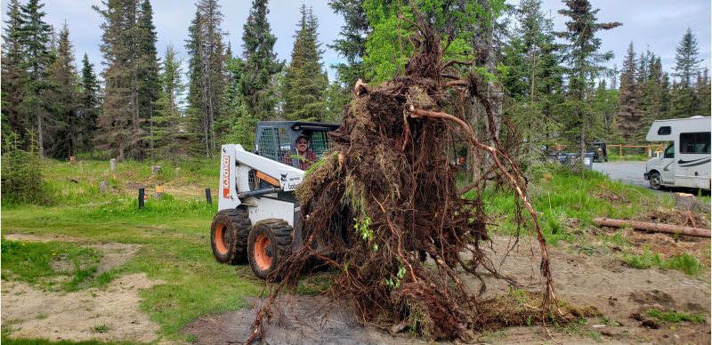

BRADISH
# Posted: 15 Sep 2021 12:38pm
As I mentioned in the last post - pound for pound I haven't found anything better for 'stumpin' than my 863 with my heavy grapple. I suppose the right mini-ex could give it a run, but then you're talking a whole new price range.
