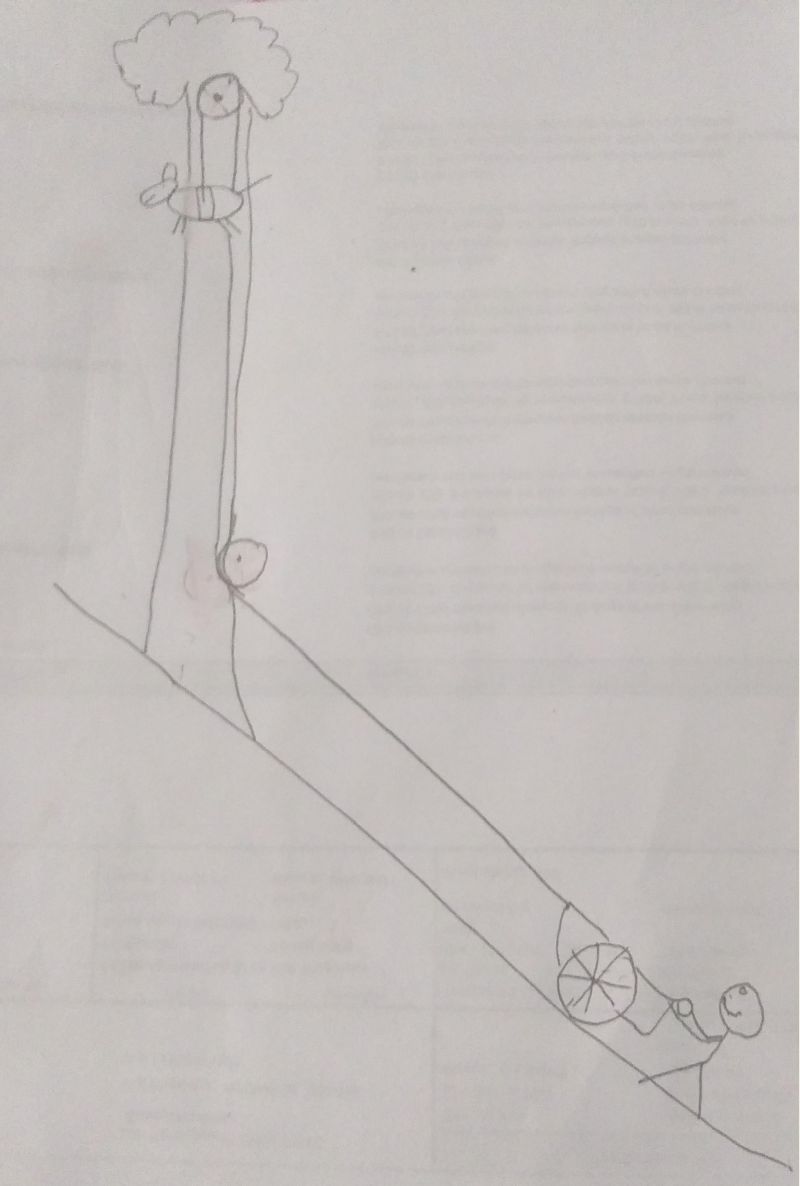

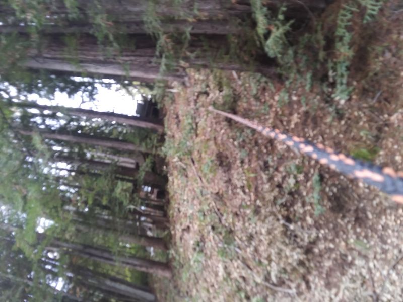

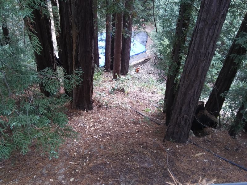

I did a bunch of defensible space clearing on the hillside below the cabin this summer, and noticed there's a clear shot down to the shop. I ran a rope today, makes it a heck of lot easier to climb and descend in the soft dirt and duff. Normal route is via an 800' switchback driveway. I go back and forth numerous times, usually with the yard truck as there's always something to bring.
I'd love to come up with a way to use this newfound path, and be able to haul tools and junk. I could probably smooth it enough for wheels, even a track. And I have enough electrical power at the cabin for some sort of winch. It's very steep, something like 45 degrees.
Any ideas on how I can make something work, overhead line, tracks, winch? Here is one idea I sketched out.

Might have to get a bigger dog

# Posted: 16 Sep 2021 03:56pm
And/or the dog will need to come in pieces so you can adjust it's weight to match the load you are taking up. Regardless, the breaking system will be critical in a setup like this to keep the load from sailing down the hillside into your shop.

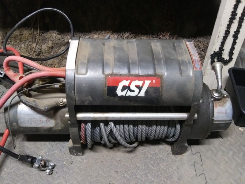

I have some winches but would be slow. Could mount bigger pulleys maybe, much less load than pulling a truck out of the mud.

Paulz. Maybe you can use the RM 80 for a power source. 🤔
I really like your hand drawn blueprint. Sometimes you don't need CAD to show whatcha wanna do. 👍
# Posted: 17 Sep 2021 02:31pm
Yeah that winch setup is tits. I took a look at what I have on the shelf, one 12v, one 110, at 10 meters a minute. Too slow I think but I could probably rig up a jack shaft with car wheel to pull the cart rope (and me hanging on).
