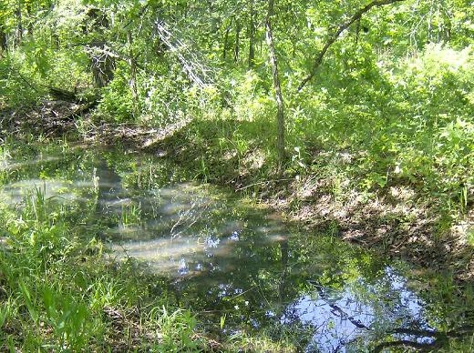

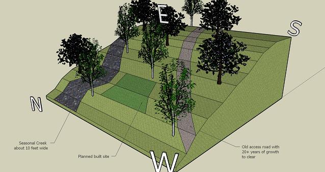

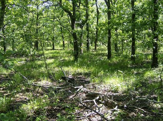

Thank you for the compliment. I like the idea of a full wrap porch or front porches, I don't know why. Maybe it has a lot to do with my grandfathers old cabin in the hills of Volcano, CA.

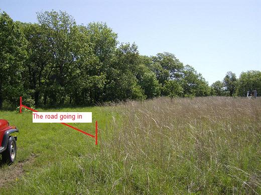

I've only been designing with limited windows due to the build site, and sun. My land has a north facing slope and the south, east, and west sides have a good amount of trees. I don't want to cut down any more trees than I absolutely have to. I think so far I only have 6 that I will cut down due to broken limbs, splits, and lightning damage.
Here are a few pictures of the land.

# Posted: 20 Aug 2008 08:20am
Reply Quote
Nice build site with lots of hardwoods and little undergrowth. Are going to clear a perimeter in the trees, or tuck it somewhere in there?
unixfmike
# Posted: 20 Aug 2008 01:08pm
Reply Quote
Hi Vince. Me and the wife are going to tuck our cabin into the woods. I have intentions of only making 4 corner/plat markers out of some sort of masonry. I don't want to cut a perimeter, or cut anything that I don't absolutely have to cut. Me and the wife are even reconsdering various floorplans and dimensions to fit the few clear areas we have. We already came up with a winding driveway solution to safely weave through the trees so that we don't have to cut down a path in. Once I get back from Iraq, I'll have about 3 weeks off to build, and I'm hoping to spend that time building and not clearing.
Mikew

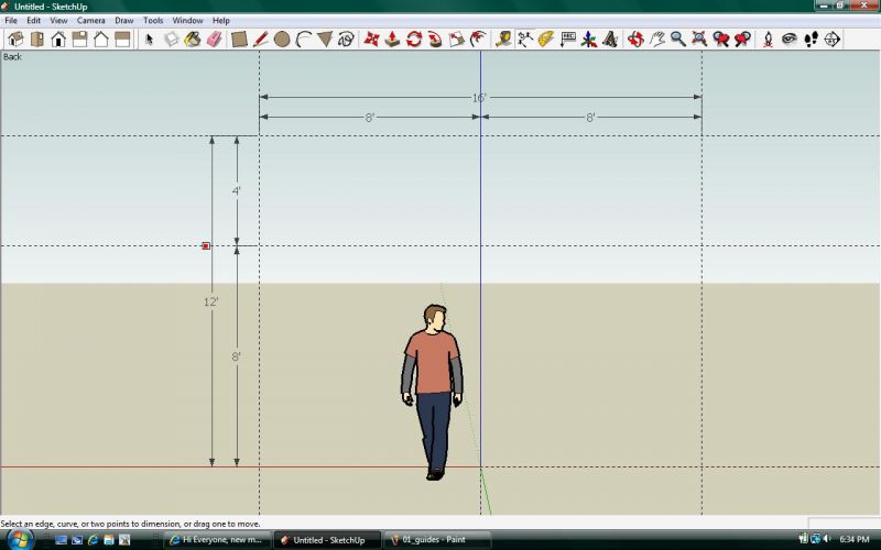

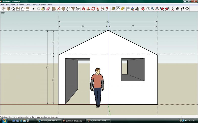

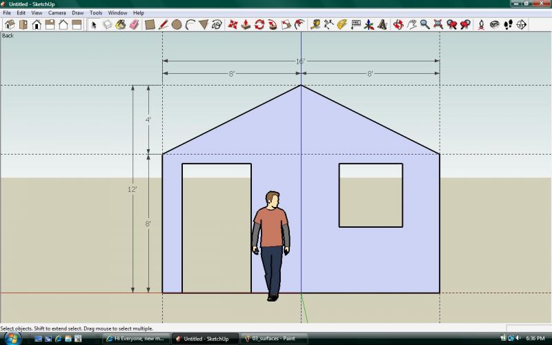

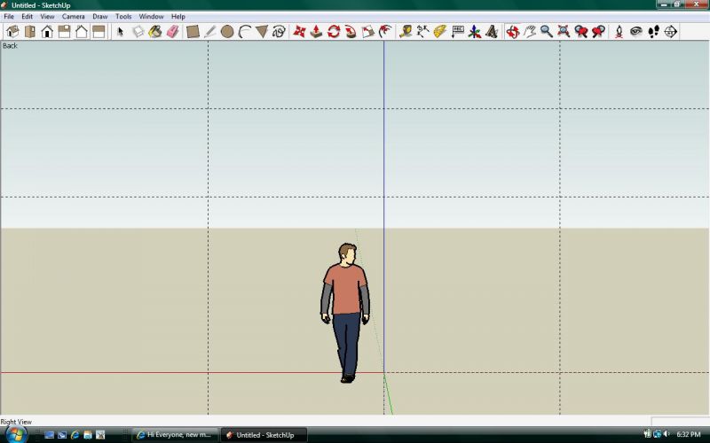

I found a great resource. I had a co-worker who was a real wise guy who always made comments like "I bet you can't do ..." or "i bet you won't make ..." or something along those lines. He continously challenged me. I found out the following things by trial and error.
1. learn to use the tape measure tool to create guides. this will allow you to make grids and then you can use the pencil tool to draw lines and make "solid" walls or objects (think of a drywalled wall).
2. use the dimension tool to put measurements on your grid so you have a visual reference of what you are doing.
3. learn to create surfaces inside of surfaces (like a window or door opening) and then delete them so you can see the actual opening.
4. learn to extrude (push/pull tool) to make a flat surface a 3d object.
Repeat these 4 basic skills learning to create walls, stairs, doors, windows, etc. As you progress mix in the paint tool (to put on colors, or textures like stone, glass, brick or wood etc.).
I seriously dislike the "baby steps" suggestion to start. I prefer to call it inexperienced progression. As you learn to perform more simple tasks you will eventually learn how to create a 2x4, then 20 of them, then rotate a few to turn the 20 2x4's into a wall. Then learn how to rotate them to make gables. Just expiriment, you can always delete or choose not to save the file. [ctrl]+[z] will undo what you mess up, and [ctrl]+[y] will redo what you just undid. Play with it and have fun.

unixfmike
# Posted: 22 Apr 2009 10:11pm
Reply Quote
Here, I hope this is a bit better help for you. It took about 1/2 hour to create, but the actual model for sample images took about 5 minutes. Best of luck, I hope this was helpful.
--MikeW
