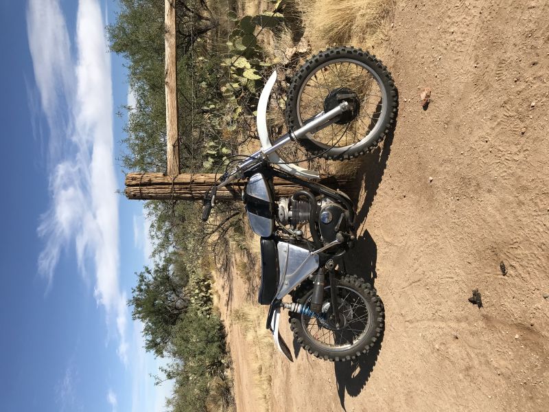

Mine is in the photo below. I purchased it from a former professional flat track racer who built race bikes for pros. Somebody through a lot of money into it with Cerriani forks, Works Perfomance shocks, electronic ignition and on and on. I have no idea what was done inside the engine but the thing has some get up and go. Way more than my 500 twin Triumph flat tracker from back in my misguided youth. Or perhaps I am just getting older. I wouldn't be ssurpised if it has a big bore kit in it. It will climb trees idling.
