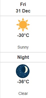

Well it looks like I'm gonna give my newly insulated cabin a real test on new years eve. Gonna be lovely and clear, but darn cold (-36C). Gonna be tired of carrying wood by the time we leave!
I convinced my wife it will be romantic
Clear. Wind up to 15 km/h. Low minus 36 with temperature rising to minus 30 by morning. Wind chill near minus 42. Frostbite in minutes.

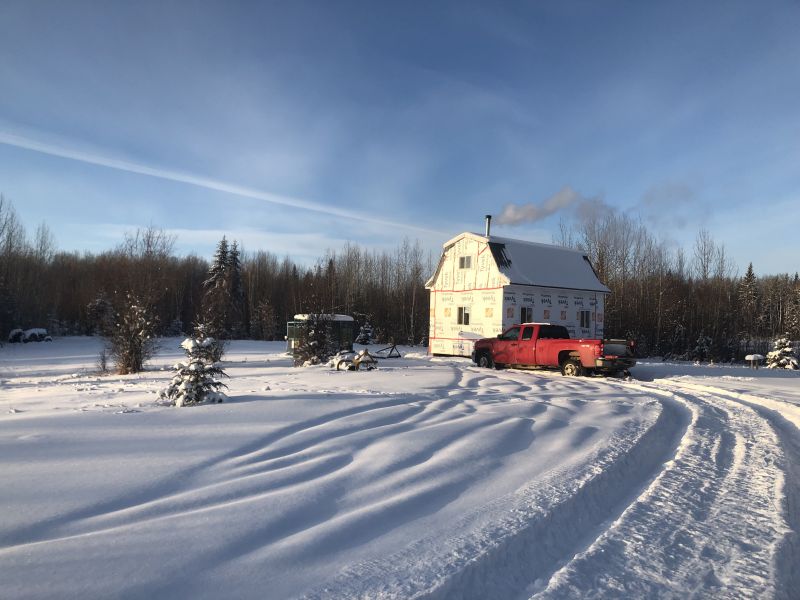

Well -26 when we got here. Been here for 1 1/2 hours, it’s plus 6 in the cabin, but outside temperature is dropping fast. Guessing it’s gonna be colder than -36c. It’s plus 15 in the loft, so we will be cozy..
Happy New Years all!

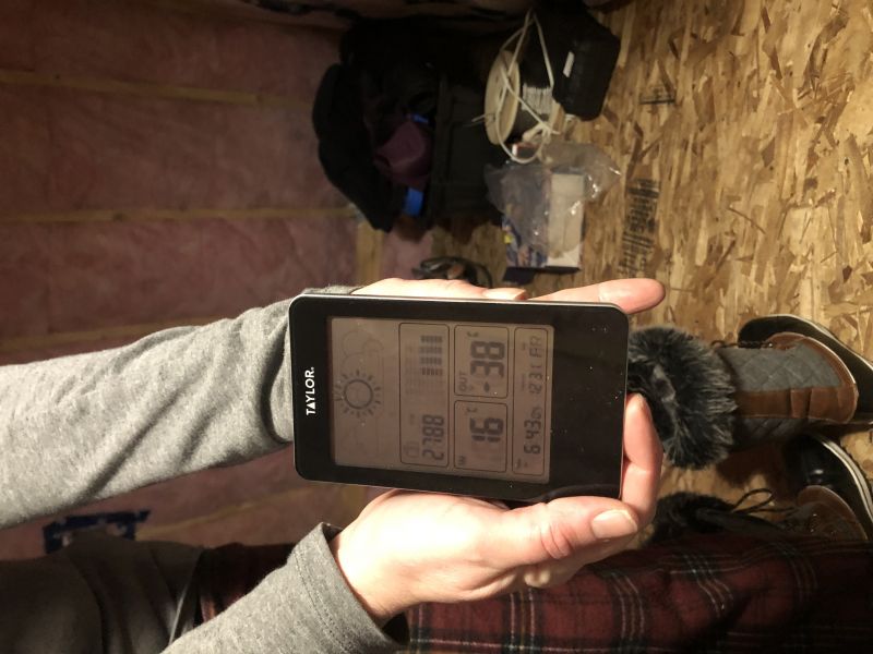

Damn.. at -38 and it’s 6:45pm.. might see the magical -40 (without windchill). Loft is steady at +16-18..
@brettny yes, wood heat is all we have.. a run of the mill Drolet wood stove.

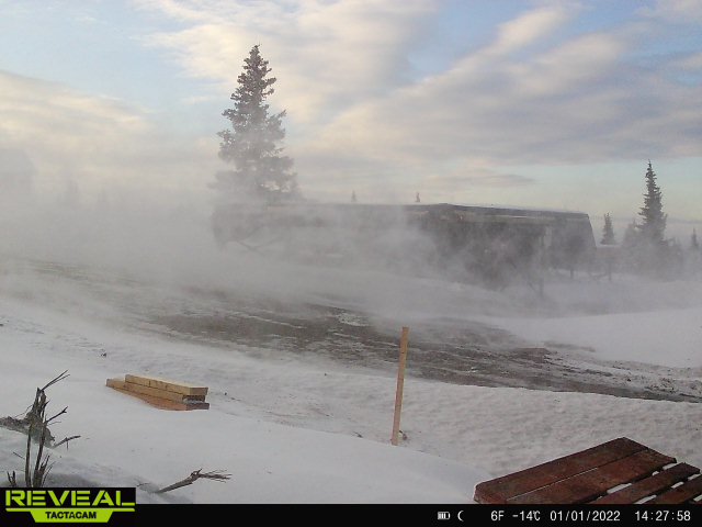

We had a decent test of insulation and build quality this NYE weekend too. 60mph winds in the 10-15F temp range made for some pretty wicked times. Luckily we were happy and warm in the cabin we use for now. Friends weren't so lucky and couldn't keep their place above 45F by noon 🤪
Ultimately we were still bested by the wind as our house in town lost power from the storm and I was concerned it may be awhile before it was restored. Loading up and drive out of the cabin was less fun with 50-60mph wind than usual.
Oh well, it was a good demonstration of nature for us as we head into the summer building season. There are a few items I plan I putting an extra few nails in when it comes time to build the cabin 😆
Trail cam at the build site still got a false positive trigger on this gust despite it's sensitivity turned down to 2 of 10, but I don't really blame it. 😁 Hard to capture was the flex of the 4'*5' picture windows on those big gusts. Free entertainment right there!
