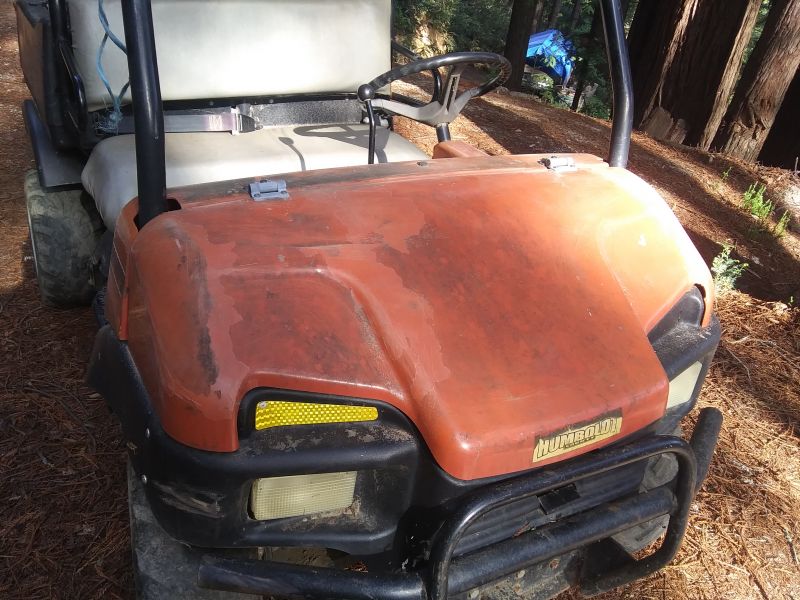

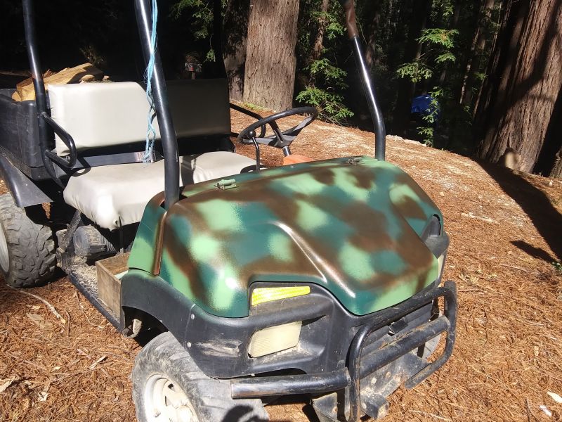

Well my new to me UTV has been doing great, the CCC (cheap Chinese carb) works flawlessly. Really bombs up my driveway, not even on full throttle. So well in fact I decided to treat it to a quick paint job today. Scuffed and washed the flaking paint off and dug out 3 cans of spray paint. 5 minuted later, done. My first camo job, not the best but better than that bright orange.
jsahara24
# Posted: 8 Apr 2022 07:48am
Looks good to me....Last rattle can paint job I did, I made up some leaf templates out of cardboard....turned out decent..

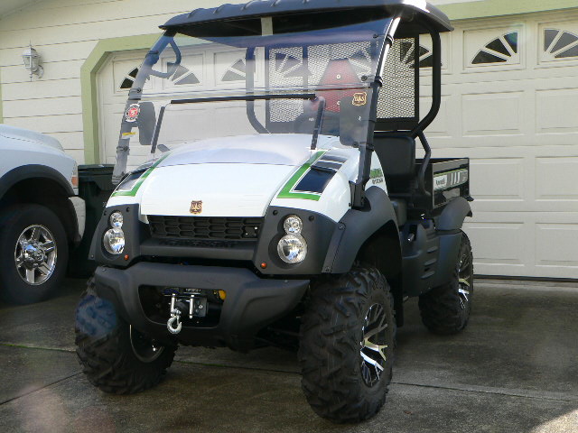

I have the Kawasaki Mule 610 at my property, I have 40 acres, this is a must have, makes little chores around the property quick and easy. Toss in needed tools, head out, fix fence, drop beetle kills, skids the logs in, haul water.... endless.
Paul, that actually looks great, huge improvement and pefect "woodland" cammo design. Now if you get real good, do the digital cammo.
Heck, too good, you might not find it. I see the rollbar. Does it have a roof? If not, add one, keeps sun off you, rain and also helps protect the seat etc from sun rain. A chunk of plexiglass down the front too, keeps rain off knees.
Mine came with roof (special edition model) and I had them add the windshield.
2015 XC SE Mule 610
2015 XC SE Mule 610

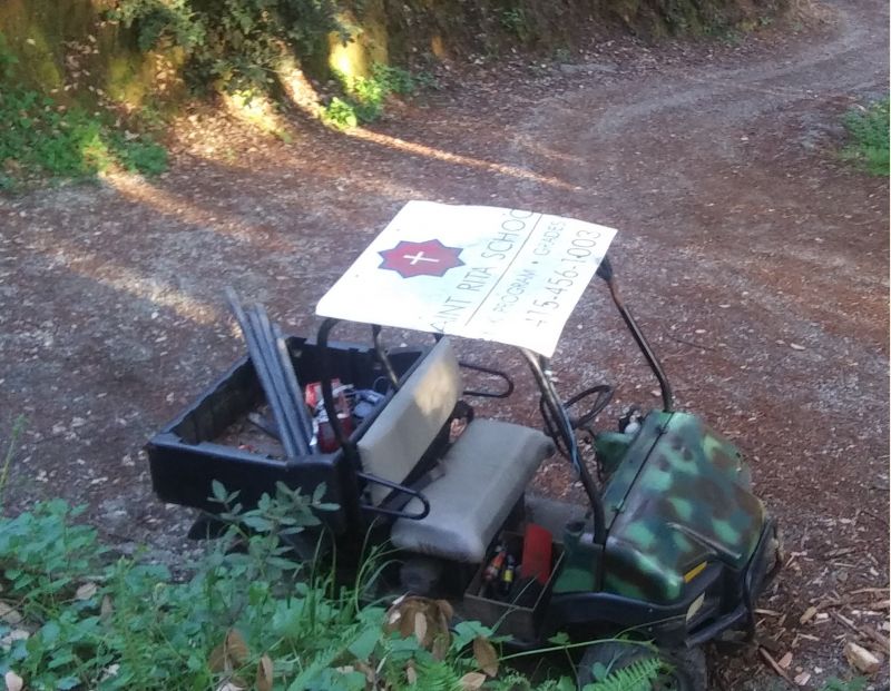

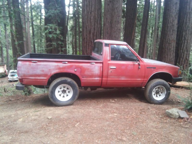

Somebody before me put this old sign on my roof. A windscreen would be nice in winter, I probably have a piece of Plexiglas around here somewhere. Especially since I have put my previous yard truck into temporary retirement. It runs great but the UTV is a smoother ride and no door to climb in and out of. Plus it's kind of a rare truck, 1980 was the only year of a Datsun badged 4x4, next year were Nissans. Probably collectible to someone.
# Posted: 8 Apr 2022 12:00pm
Ha! Your utv is camo'ed from above disguised as a sign.

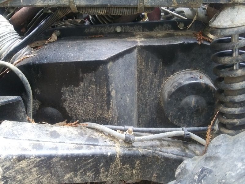

I still have one issue with this thing. It has a centrifugal clutch, and CV trans I think. The whole thing is encapsulated in a dirt free cover, no easy way to get at it. When first started, the clutch is free. As you put it in gear and give it gas, it engages and off you go. But when you stop, even at a low idle, the clutch does not disengage, can't shift into neutral, and it creeps along. Have to turn the engine off. Then it disengages. I can still drive it fine, I just have to shut it off every time I stop. I'm guessing that the springs that disengage the clutch are weak or broken.

I've thought about that. It does have an air inlet tube (I think, upper left). The frame is in the way of removing the big cover. Last thing I want though is slippage. Were you able to spray right at the clutch? I could grab a hole saw and cut a hole...

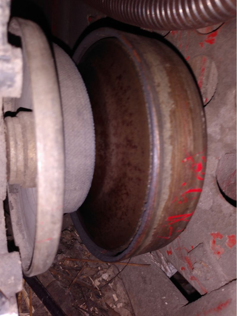

This is what I have. I've seen the same set up on snow machines and gas golf carts. When I put the wd on. I try to get it in between the outer hub and the throw out mechanism. I have gotten some dripping where the belt rides. Not gotten enough on the belt to mess it up. It is a new belt. But the clutch is over 40 years old. As TMT said adjusting the idle low enough might/ should prevent the grinding when switching from forward/neutral/ reverse. I know I need to rebuild or replace the carb. So sometimes I have to play with the manual choke to idle down without grinding the trans.
I know part of my deal is that I drive thru water, mud, and mostly dusty gritty trails.
I have used the wd method on go karts mini bikes etc. But those have chain drives, so over spray doesn't make a difference. As gcrank said. There may be an adjustment in the clutch itself. But pulling the clutch off might be a bitch in tight spaces. If you can get access to try the wd. You have nothing to lose if it doesn't work.

I still may take a hole saw and cut a big hole in that cover opposite the clutch to have a look.

Fixed! I cut a flap in the cover, lubed the shaft and the centrifugal linkages. Also was able to stretch a spring in the complicated governor/throttle linkage and get the idle down a bit more. Thanks guys!
Took a video, you can see the pulley move out and suddenly snap all the way when revs get low enough. Just going to bend the flap back and tape it over so I can lube again if needed.
