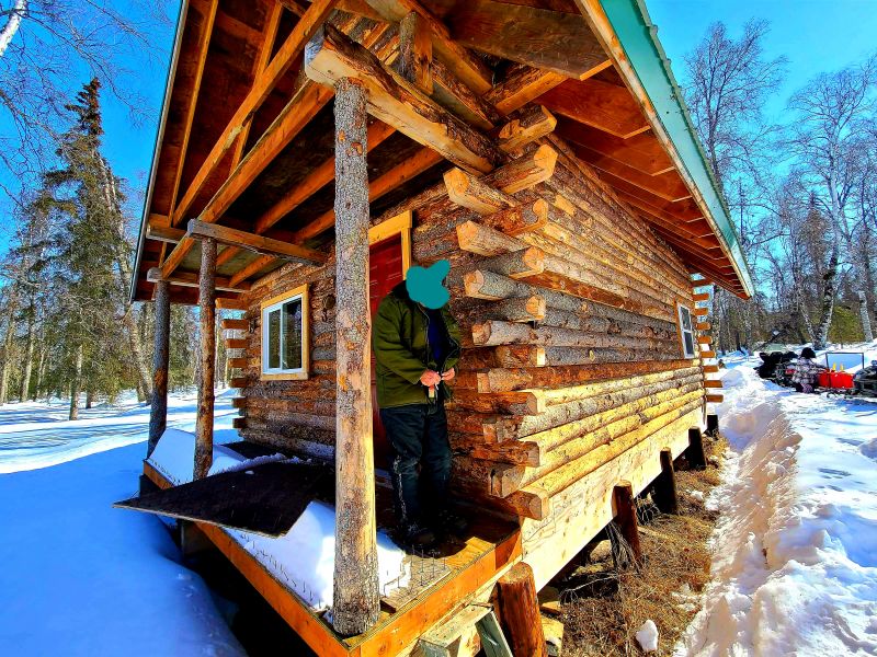

I came across some pictures that show a bit about the construction techniques used in building our cabin. This was making a fuel run and just for fun. You can see the pass through technique. The 2 logs extending out to support the upper deck are 8" wide. A bit bigger. As they also hold the TnG 2x6 pine floor in the upstairs.

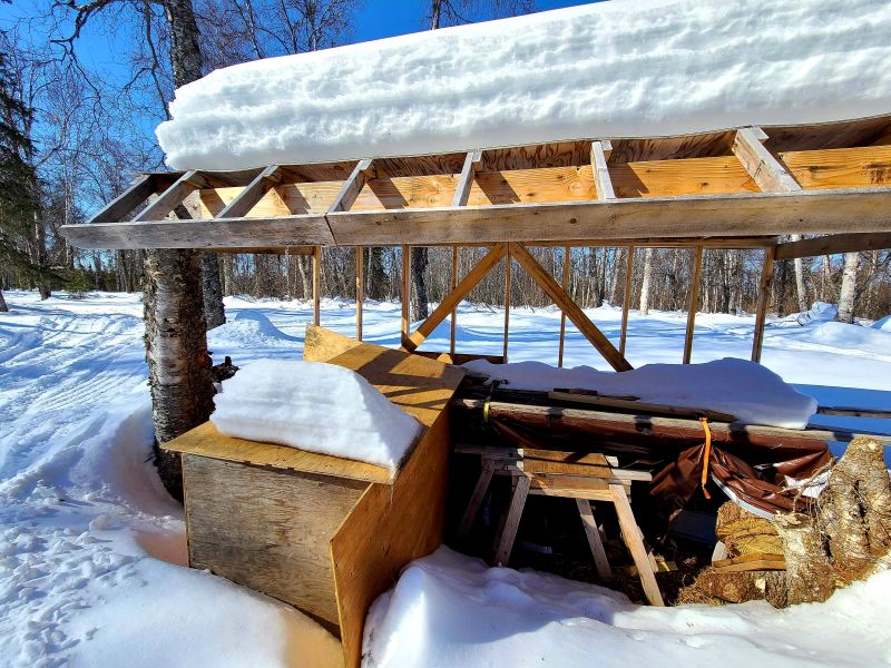

A picture of the woodshed, it will get 5' of standing settled snow on it. I had to stash a 4 wheeler n lumber to build a 3 place wheeler shed. And the logs we skidded up for firewood are behind the shed. Never enough time for fun. Doubles as a meat pole. Some real bush ingenuity eh.
And the bear boards on the deck. I did have a bear poke holes in the front windows screen. Apparently while I was out I had a curious bear visit. The screen was torn off but the window was closed. It tried.

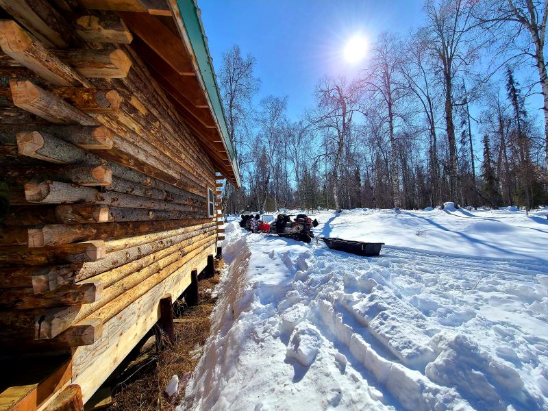

When I was designing this cabin I wanted the snow to clear away from it. I also had to bearproof it so windows are 7' up. I do need to make some boards to screw up under the windows as more protection. And since everything has to be freighted in , I used the utility poles for the foundation. Easy to get everything level n stay secure.
The roofline n such are still perfectly straight after several pretty good earthquakes and the floor is level so seems to be working ok.
Thinking I'm going to try a power washer the finish peeling the logs. They should come out looking a nice yellow color. Caulk n finish with a goodnight oil. Put a good paint on the exposed rim joists laminated beam n such. I do have some quick create in the generator shed to put a cement collar around the bottom of the utility poles but they stay dry.

Very nice. I like the utility pole idea, easy to keep track of or replace. And the second story balcony.

That is called the "Butt-n-Pass" method, preferred method of the LHBA

Great pictures! Are you running low on firewood?
# Posted: 5 Feb 2022 10:36am
Yeah looks like the wood pile is empty. The cabin is full though. Probably have to go get some dead standing spruce n birch. The spruce bark beetles wiped out most of the mature spruce.
Getting firewood in the winter is ok. Nice n cool. Kinda nice if the snow isn't 4-5 deep but not bad. And cutting firewood under the light of the moon is kinda nice. Especially if the northern lights are dancing.

^^^^ This post was from a world I've not seen. Different thoughts and a different world from mine in Tennessee. Like your cabin, thinking real serious of doing a butt and pass myself.
