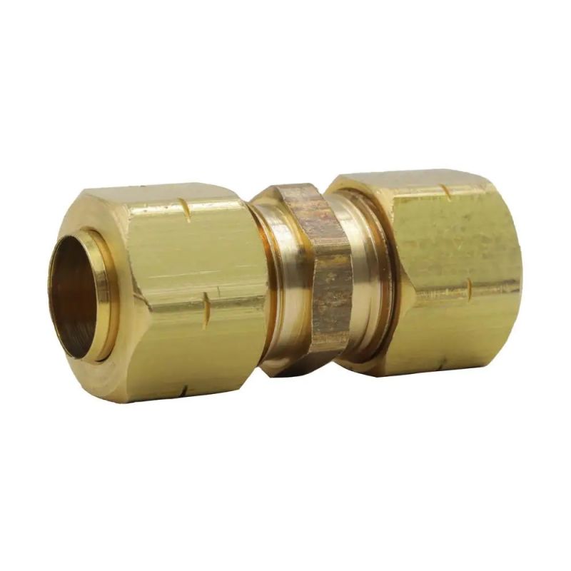

What kind of compression fittings?
Do you mean compression fittings with an olive? Like the one below?
Or do you mean the compression fittings where you use special pliers to squish the ring around the pipe?
# Posted: 23 Feb 2022 11:00am
An olive? New term to me. Yes, like the pic, only it's a valve not a coupling. Slide the nut on, slide the brass ring on, slide the valve on, tighten the nut.
travellerw
# Posted: 23 Feb 2022 11:16am
I think its a more common term in Europe. If you look at the brass ring you will see why its called that.
Anyway.. I think you are asking for trouble if you are using fittings with a brass ring. I have seen them work without issues, but technically there are different compression fittings for plastic pipes (pretty sure they have a plastic olive). I wouldn't trust one in a critical spot where a leak could go unnoticed.
