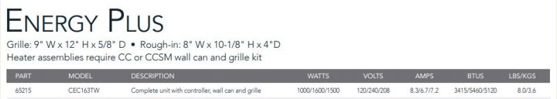

I was leaning towards this one.

For keeping just the the bedroom warmer, I'd think that one would work great! Built in, more precise thermostat, and a fan that slows down when the temp difference is small? Seems like a win....keeps things simpler than my setup.
And I'd think 1000W would be enough for an insulated bedroom.

If i wire up the one i've linked above as 240, it actually is rated at 1600 watts then. Since this heater will be on an inside wall and less than a couple feet from the panel in the bedroom, i guess i might as well sacrifice the extra slot in the panel and wire it for 240.

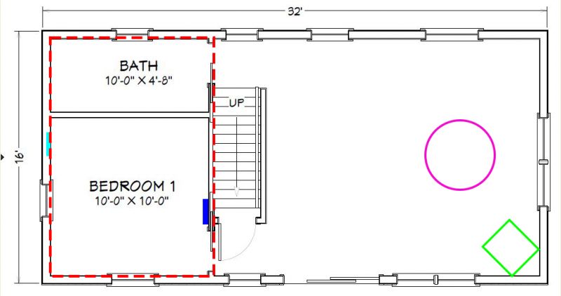

In the floorplan photo the green rectangle represents the pellet stove. The pink cirlce is a ceiling fan that i'll put in which will be around 12-15' up from the floor. The dark blue box in the bedroom is the in wall heater we're talking about here. The dotted red line shows the loft that's above the bedroom/bathroom area. The light blue box on the left is an idea i have to circulate the air from the loft, through the bedroom and through the bedroom door out to the main area. Figure i can put a floor register in the loft floor and then into the bedroom ceiling with an inline fan.

OTOH, going to the 240V 1600 watt version will help heat things up quickly. 1600W for 100 SF with a standard ceiling height vs the 4500W I'm using for 520 SF will do nicely.
# Posted: 1 Mar 2022 08:22am
Wheres the pannel in that drawing?

Half way between the dark blue rectangle and the corner.

Is that pocket door going to interfere with wiring/hanging that heater? The one you linked is recessed I think.
WILL1E
# Posted: 1 Mar 2022 09:44am
That's an old floorplan drawing i had handy, it's going to be a regular hinged door that'll be hinged on the left as your going into the room.

So i run 240V and use 12-2 wire, I would use a 20amp breaker right?
The manual for the heater says it's only pulling 6.7amps for 240...any reason i couldn't do 14-2 and a 15amp 240 breaker?

Yes you can use 14 gauge if you're only pulling 7 amps.
