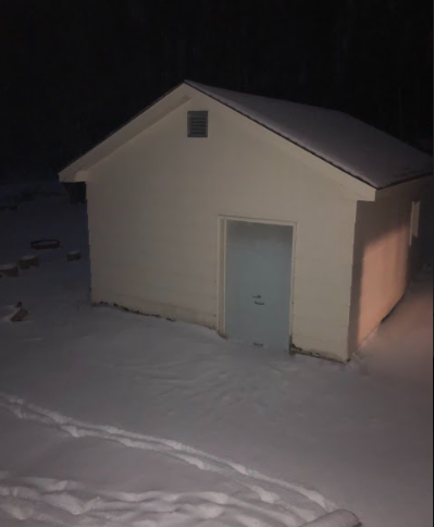

Hey Folks,
I have this 16x20 woodshed and I want to turn half of it into a sauna/changing room, the other half just stays woodshed for sauna and house needs. Floor is cracked, looking for some feedback as to what to do to address water and drainage. Foundation is likely to continue to sag, it's clay soil in Upper Michigan. Image inside is the sauna space to be, 8x8 or so. Thanks,

Lay 2x4 PT floor joists down then PT plywood over it. You dont really want to be standing on a cold concrete floor anyway right?
You could even do deck floor boards and not plywood

# Posted: 8 Mar 2022 08:17pm
Fancy isn’t a goal, function is…just wanted to drain away water as it will see plenty of use. AK, you most be a sourdough! 😂 pond liner into a drain was a thought
