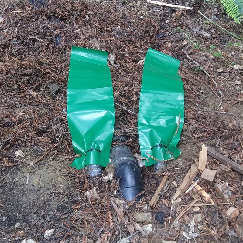

# Posted: 13 Apr 2022 02:00pm
I was at Ace hardware getting some other stuff and, being both cheap and lazy, decided I'd try gcrank's low tech suggestion. $9 for an 8' piece, enough to do both the sink and shower. The pipe in the middle runs to a 500 gallon black water holding tank, gets pumped once or twice a year, 100 bucks per.
Photo taken before covering with duff. As yet untested.

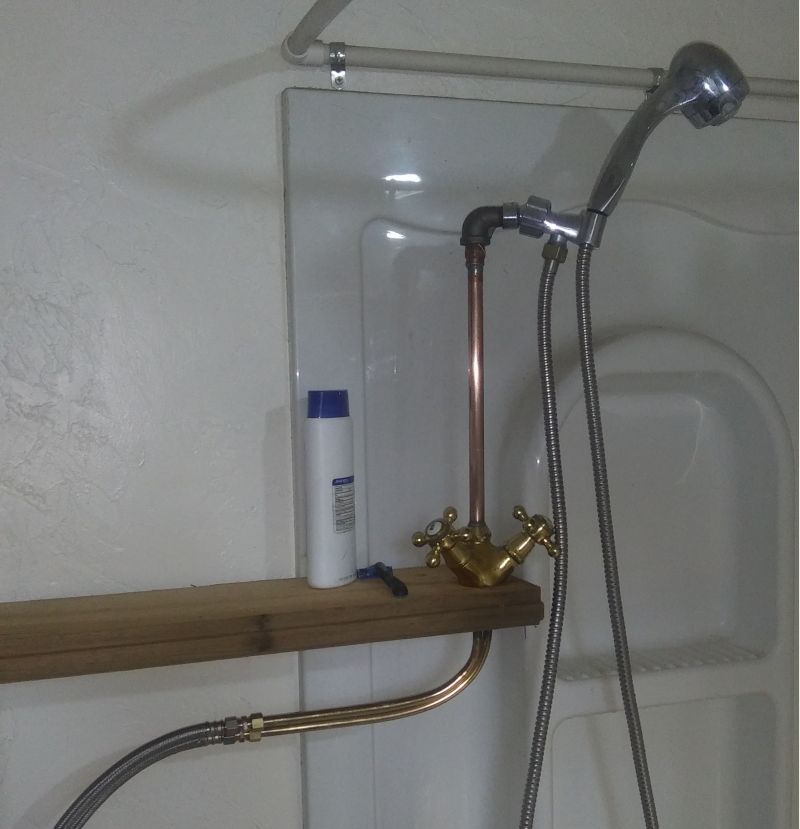

# Posted: 15 Apr 2022 12:52pm - Edited by: paulz
Now that that's in place, I've completed work on the indoor part..
When I scabbed the bathroom onto the back of the cabin I had no shower parts or plans, so I just put valves down behind the toilet. Then, driving to the cabin one day was a yard sale sign, not a mile away, and I picked up this new but cheap plastic shower stall for $20, including the pan. Then a friend gave me the neat brass valve setup. Made the curtain rod out of PVC. I just bought the two braided dishwasher hoses and hooked them up yesterday. Won't win in best cabins and showers but it does the job.
# Posted: 15 Apr 2022 01:47pm
Hey, thats got a bit of a 'steam-punk' look

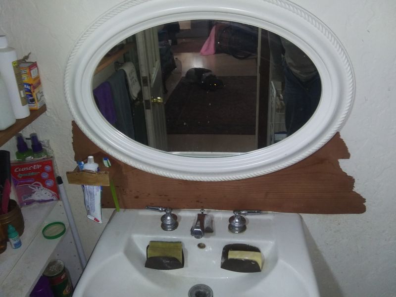

# Posted: 18 Apr 2022 08:53pm
Just wait till I add a couple more elbows and 45s.
Been getting some much needed wet weather at the cabin, so I've been farting around inside. Needed a back splash and toothbrush holder for the sink, so I grabbed an old redwood sliver from milling my siding a long time ago. It was gray and dirty. Found some Deckswood cleaner on the shelf, brushed it on and whamo, 10 minutes later is looks like it came right off the mill. Also hacked out a quick toothbrush holder.
# Posted: 18 Apr 2022 09:42pm
Well Done.

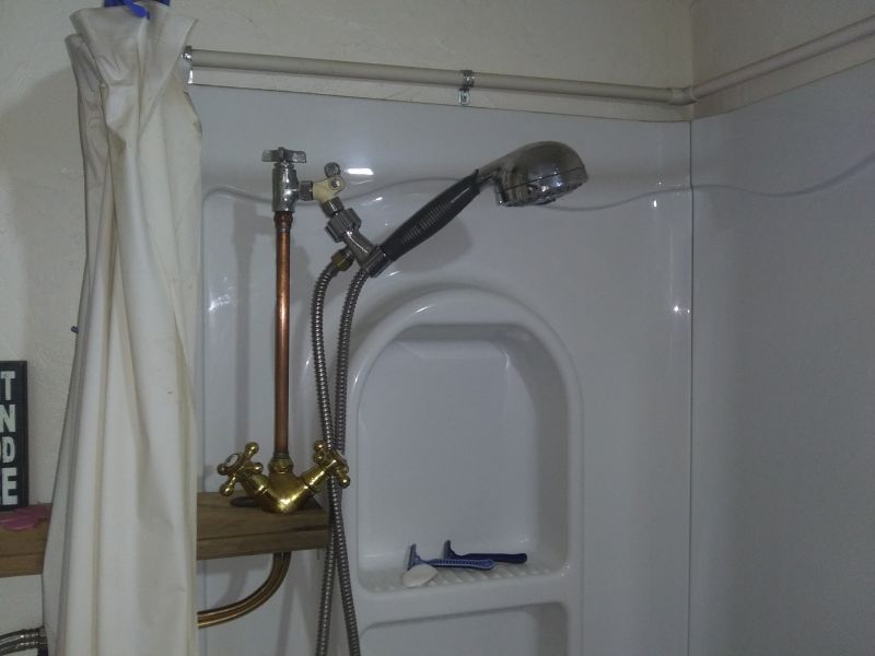

Told ya, lol. Through a lot of naked trips to the L10 knobs outside, I have finally gotten it set for indoor shower use, had a couple of good showers. Flow knob all the way down (so it turns on at lowest pressure) and temp knob almost all the way down. The result is the hot on all the way in the shower and crack the cold just enough to cool it down but not enough that it lowers the pressure and turns off the L10. Once set, don't touch it! Problem was every shower head I have tried that has an off position still leaks enough when off that the pump cycles every few seconds while soaping down or shaving. So I put in a another valve up top that shuts off the water without changing the settings. Had the parts already in my ever expanding plumbing box.
Thinking about trying another, larger, pressure tank. That would cut down the cycling but when you want hot water it has to cycle through the water in the pressure tank, I think..
