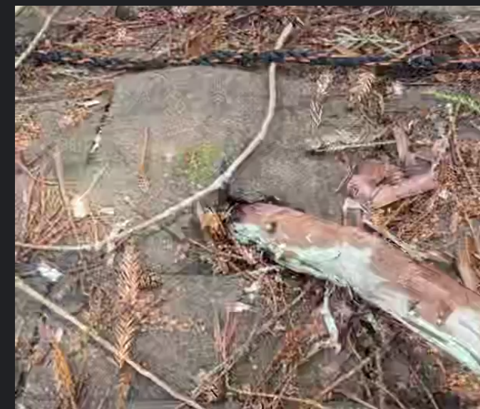

My widowed neighbor (same one with the log splitter) had a branch come through the roof. I'm going over there today. She sent me a photo. Looks like she needs a new roof but more rain coming this week. Also look like regular tar shingles. Can I slide that one out and slide a new one in, or is it better to just Black Jack a patch over or under that one?
# Posted: 19 Apr 2022 10:49am
As a temporary fix I'd do both. Clean the area around the hole and carefully lift the shingle/s directly above. Pull the stick out and Blackjack the area around the hole... then slide a new shingle under the one/s above to cover the area with the hole. Put a couple roofing nails in the one/s above to hold the shingles in place.
nitch11
# Posted: 19 Apr 2022 11:04am
Take a putty knife and wiggle it under the shingle above. Do this very gently as they look very brittle. Tar the hole and slide a new shingle under it. May want to have a heat gun, bend slowly or most likely it will break...
pabear89
# Posted: 19 Apr 2022 11:58am
Old shingles are very brittle and do not take tar seal well.
That said, clean off area and use propane torch to heat shingle where patch is to be made first.
While warm cover with tar and place a new shingle patch to cover hole then seal edges.
# Posted: 19 Apr 2022 02:29pm - Edited by: paulz
Thanks guys. All done. Slid a new shingle under, cut a piece the size of the hole on top, glopped the whole thing with Blackjack.

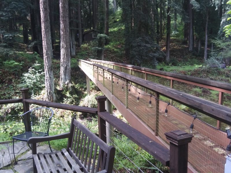

She has an amazing property. Check out this foot bridge above a creek, must be 100' at least. The roof was actually on her guest cabin, just visible on the hillside in the photo.

# Posted: 19 Apr 2022 03:53pm
You can use a propane torch to heat the shingle above it and pull it out. Just rip the shingle off the nails and bang them in. Then put a new one in. No sealants needed.
