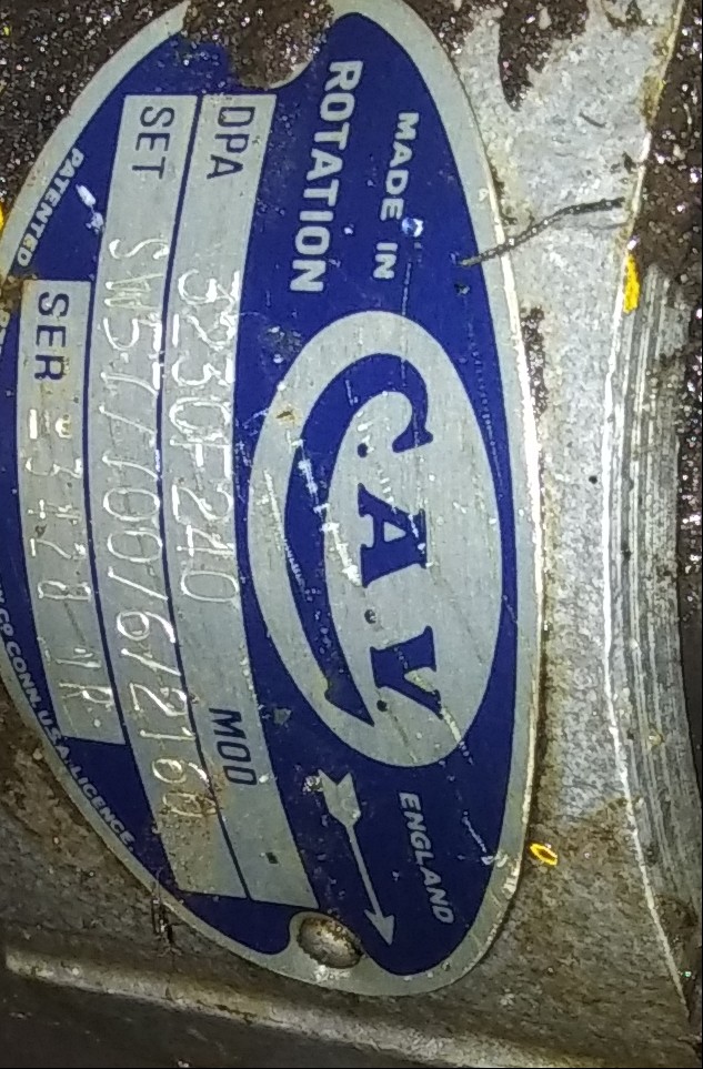

# Posted: 17 Jun 2022 09:32pm
Mine is a '74, I've had it 10 years, never leaked until this year. I've identified the leak to a large o-ring that seals the pump head to the body. Gotta come off and apart. Going to be a bear to deal with, buried in there behind the frame and loader. I put a quart of ATF in the fuel yesterday and used it today but probably too soon to see if it helps.
1tentman
# Posted: 18 Jun 2022 03:19pm
Paulz what brand diesel pump is it.
# Posted: 18 Jun 2022 04:21pm - Edited by: paulz
It's a CAV pump.
# Posted: 12 Sep 2022 12:45pm
Well I'm happy to report the quart of ATF I put in the last tank of diesel in the backhoe seems to have done the trick. Used it yesterday, no leak! It may not last but at least now I have a rebuild kit at the ready.
