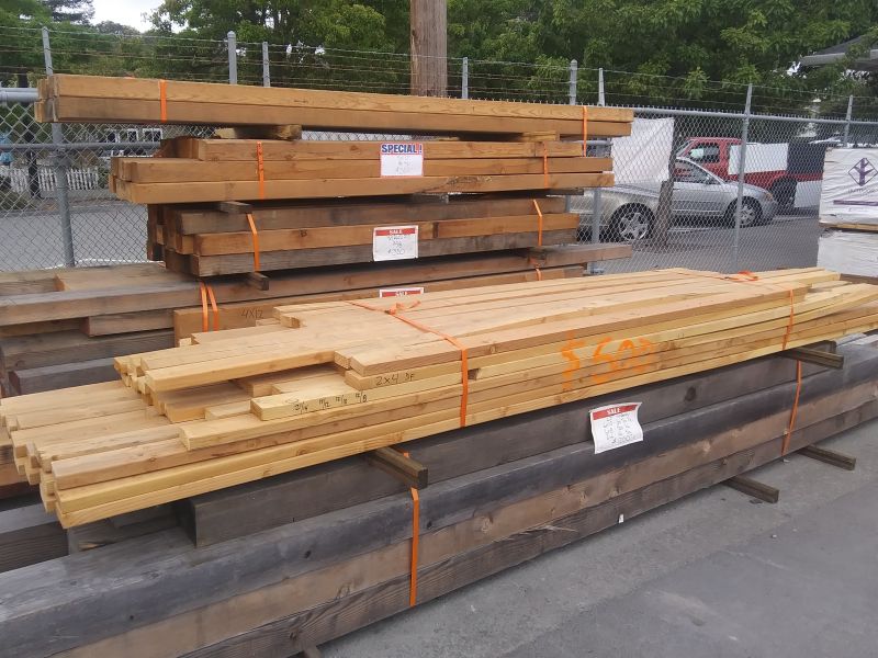

BTW, I stopped by the lumber yard today for a friend who needs some 2x4. Stack of about 60 in the bargain area, mostly 12' or more, $500.
