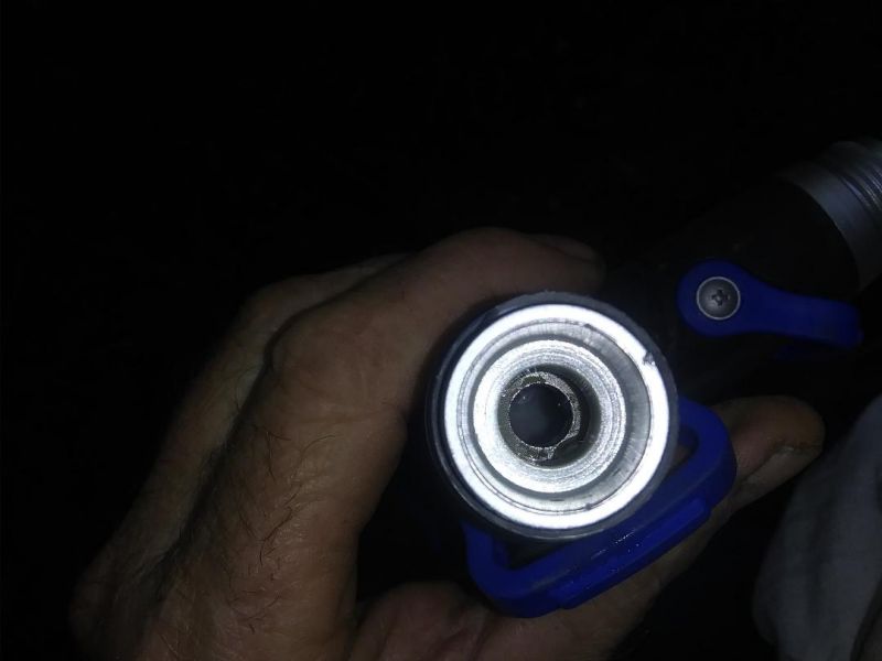

I bought a 'high flow' garden hose Y with ball valves. I expected the valves to have garden hose size holes, 5/8 or 3/4, but they are only maybe 3/8 or 7/16. So I tested it, filling a 5 gallon bucket in 45 seconds from my well pump, with and without the Y. I expected the small holes to slow it down, why doesn't it?

The small holes increase the outlet pressure, they dont reduce the volume being delivered.

They may be true to a point, what if the hole was 1/8", not going to fill a 5 gallon bucket in 45 seconds that way.

The small hole doesn’t make more pressure (pumps and elevation make pressure) it increases the velocity, it will also cause pressure loss through friction but in such a small fitting it is negligible. If you choked it down to 3/8 for 50’-100’ you would see lots of pressure loss
