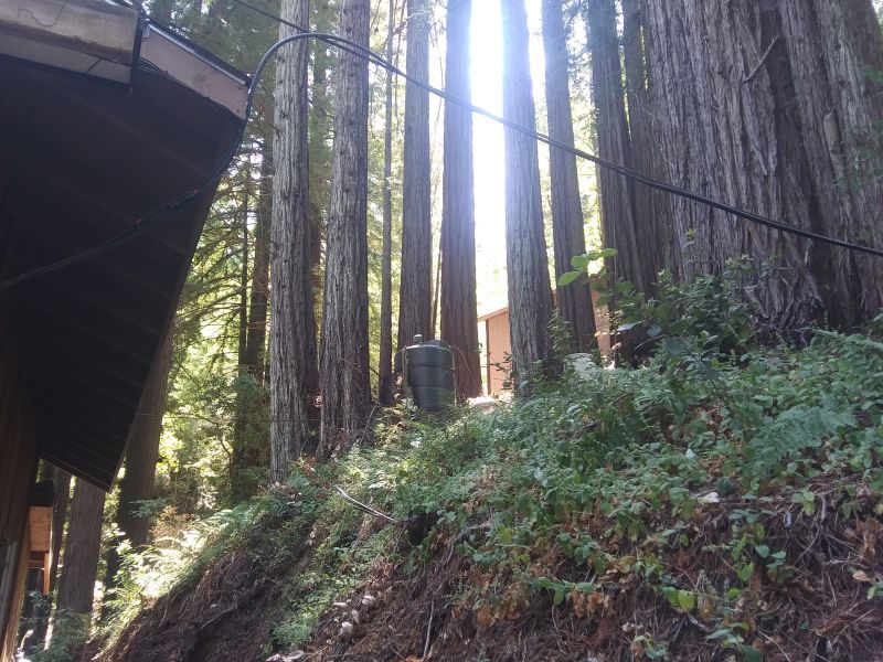

I'm letting my green 750 gallon water tank run empty so I can level the pad which has settled. I've taken it down once before and cleaned out the layer of sediment at the bottom, wasn't easy through the 16" cover. Wondering if it's worth the bother again. The outlet is several inches above the bottom and the thin layer of sediment. What do folks do with water tanks that can't be easily cleaned?

I duct tape a piece of 1” pvc to a garden hose and run it down the hill. Get a siphon going and “vacuum” the tank.

Surely the tank has a large outlet at the bottom. Can you tip in onto that edge so the outlet is at the bottom and use a pressure washer?

Great ideas, thanks. Don't know if my pressure washer hose is long enough to reach up there but I will have to tip it to level the pad. The vacuum idea would certainly work.
I can't tell yet how much sediment is at the bottom, been about 4 years I guess since I cleaned it, and it was not much. Just wondering if it's a matter of course for water tanks to get the bottoms cleaned? It would probably take 50 years for the sediment to reach the outlet port.
