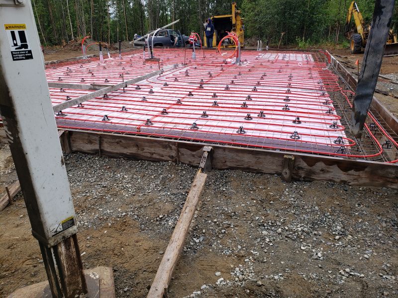

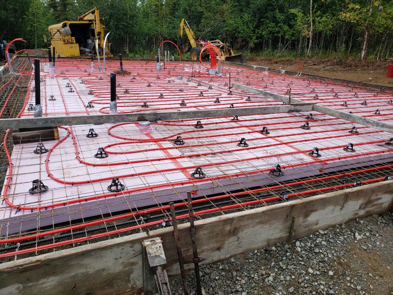

Here's a picture of the trusses going up so use all can see what I'm talking. 4" of pinkboard R-20 will go around the outside of the perimeter of the heated slab. And also running horizontally for 4' out from the foundation. 6% slope for drainage.
I put more heat tubing in than is typically used around here according to the expert who installed it. I placed it at 8" on center. Believing that more thermal mass will help keep the boiler from short cycling and more protection from the minus 40 stuff. R-20 ridgid insulation is under the cement.

Before the pour,  heating tube layout

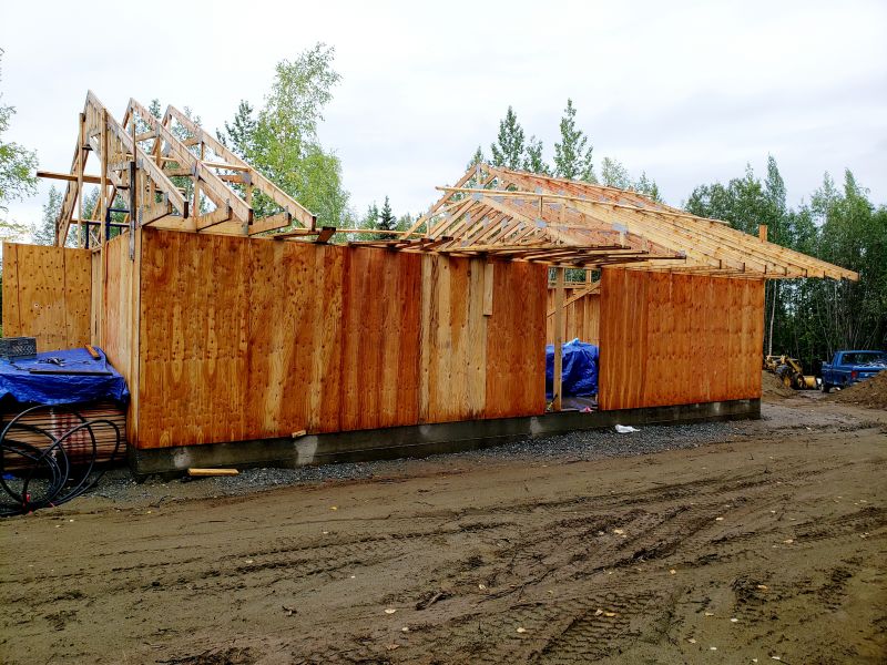

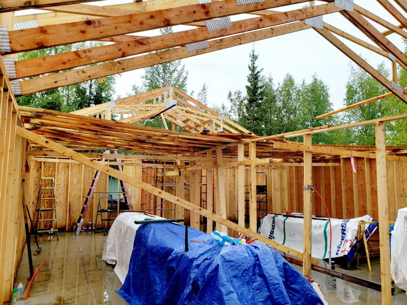

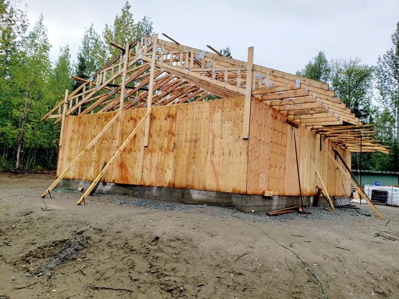

I did get some pictures of the walls
Moving forward, always moving forward
North wall
North wall
East wall
East wall
Looking up
Looking up
Before the pour
Before the pour
