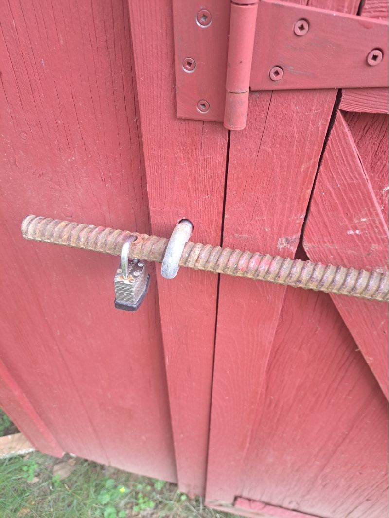

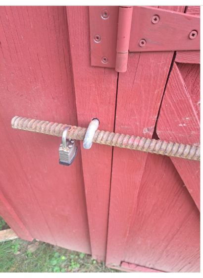

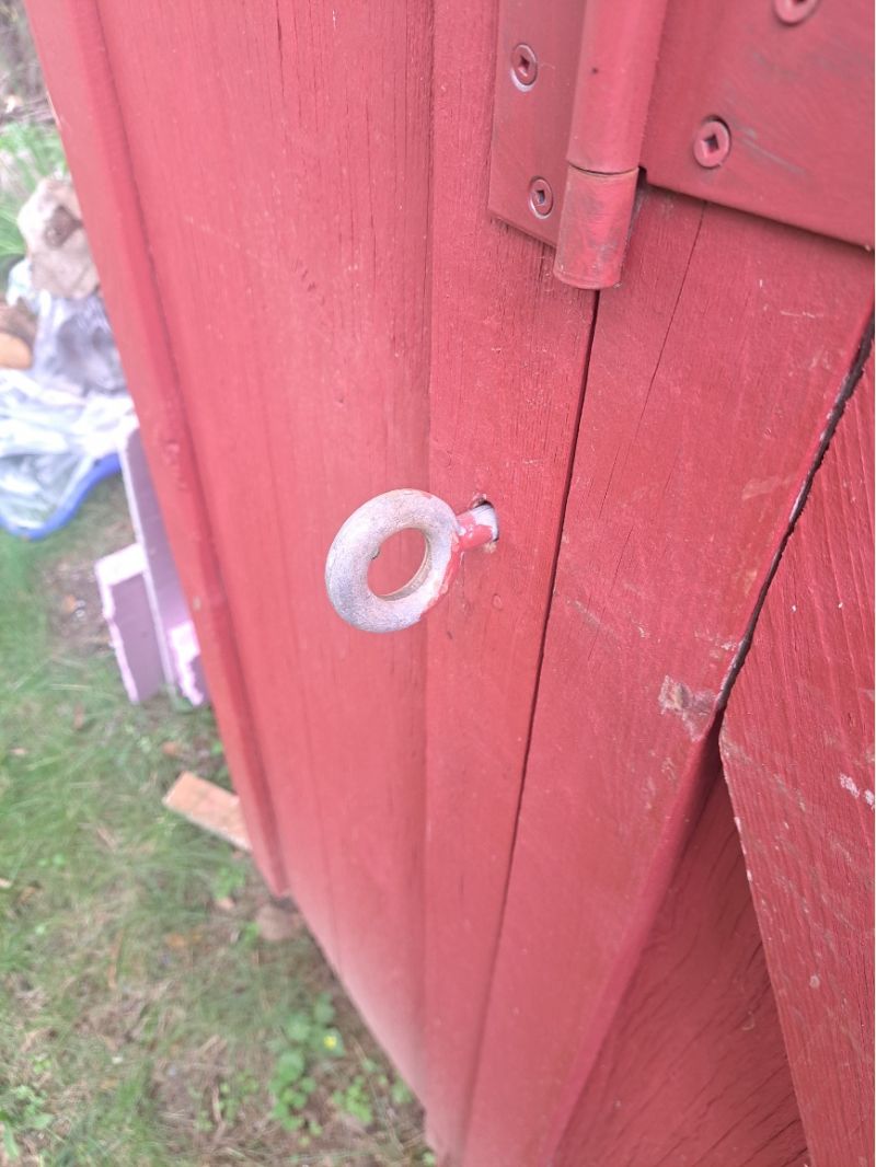

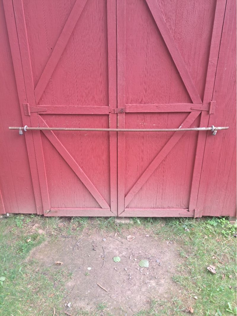

Never going to stop someone if they really want to get in. You can slow them down or discourage them and they might move to an easier target. He's my set up but you are limited to the quality of strength of your padlocks.

And like Paulz said, anybody with a cordless grinder and heavy duty cutting disc will be through it quick

Quoting: kittysmitty
You are also assuming that no one has a screw driver to remove the hinges on your door behind the re bar and padlock.
