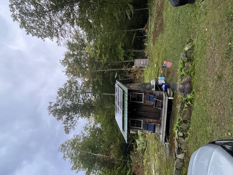

I’d like to insulate my bunkie to keep the drafts out in the mid-winter. Southern Vermont, I’m planning on a 24x24 cabin in a few years, so just making this work for weekends and the occasional longer stretches. We have a direct vent propane heater, the top bunk gets very warm but the floor is cold. Limited room to get to the floor from below the cabin.

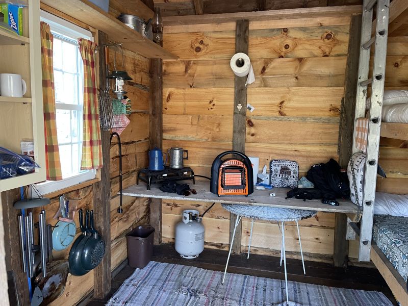

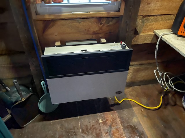

Hope you dont think that LP heater pictured is 'direct vent'.

I should have mentioned that! That pic was when we first purchased the place, prior to adding solar and the direct vent heater. Here's a pic when I was installing it, has been cleaned up since. Good idea on the fan, we do have a pure sine wave inverter which I mostly use for the Starlink dish.

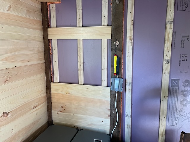

# Posted: 17 Oct 2022 10:23am

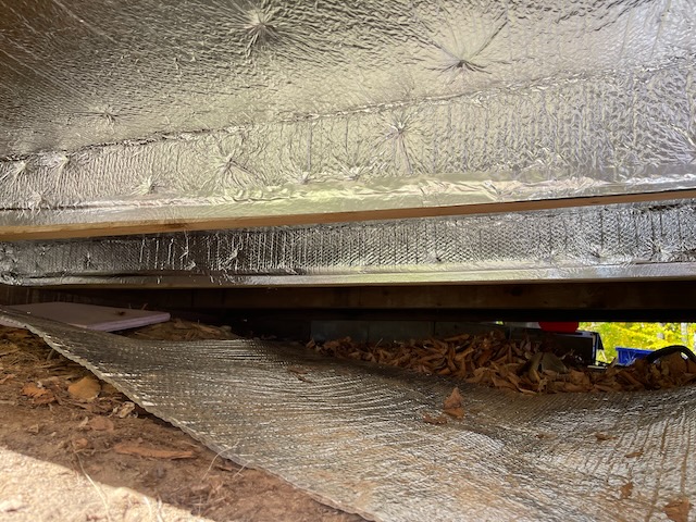

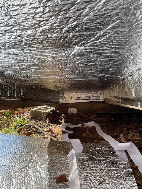

I've got about 80% of the insulation installed and 50% of the furring strips and pine boards up. I was able to get under the cabin and used bubble foil between the floor joists. That alone has made a huge difference. You don't feel the giant drop in temperature from the second bunk to the floor. I put in a small USB powered ceiling fan to push the heat down and that has helped too. It was only down in the high 30's over the weekend, but I didn't have to turn the heat up very much to keep it warm. Appreciate the suggestions, I'll get an update once it's all done and the temps get cold.

# Posted: 17 Oct 2022 11:27am
Bubble foil isnt really a insulation. It's more of a radiant barrier. You will have to let us know how the floor feels when it's really cold.
