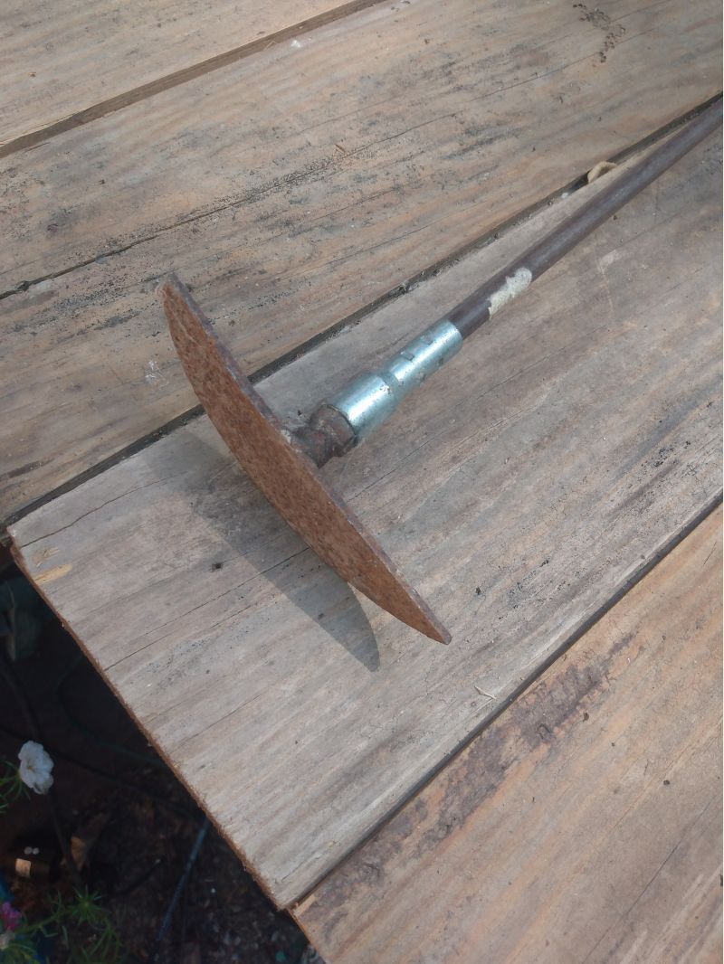

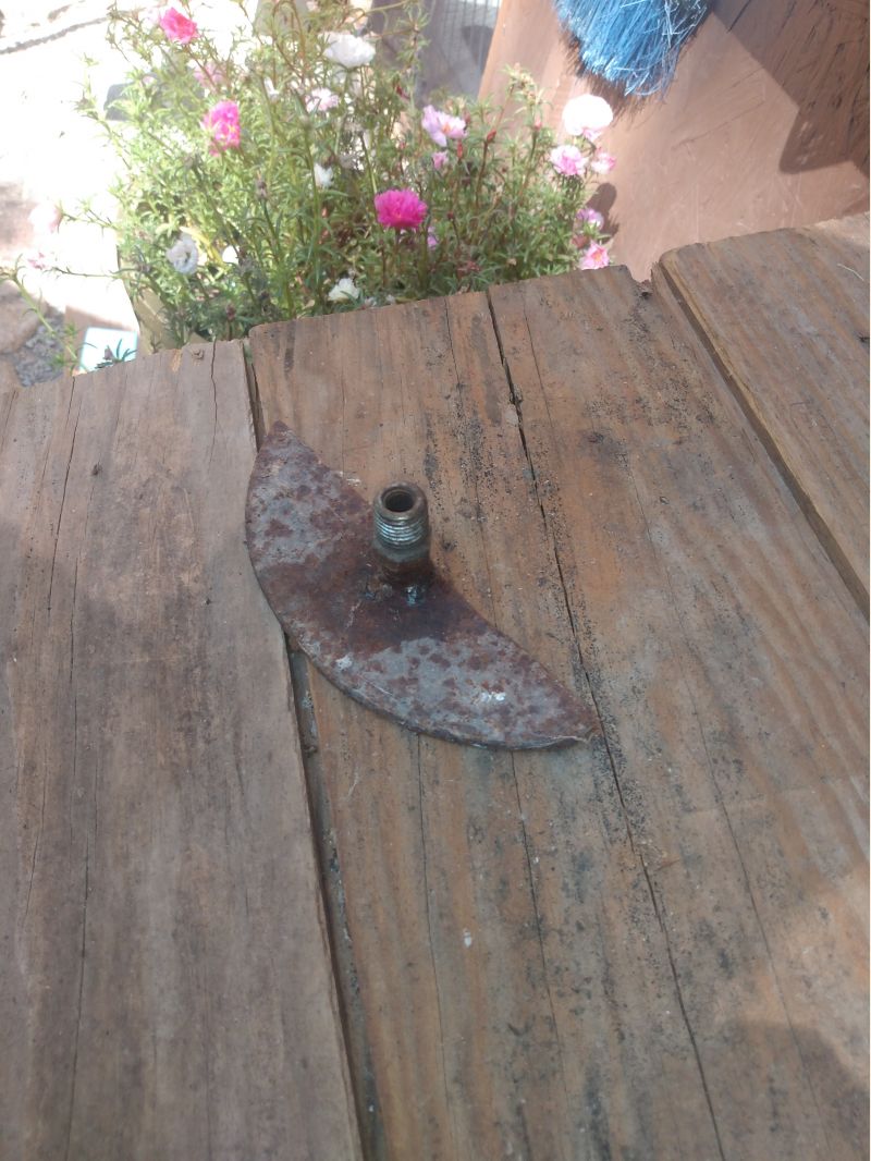

I made this to go on the end of the brush pole.
I used an air tool fitting and a scrap piece of metal. I too have a tee on the outside for easy disconnect for cleaning. With this, I can simply pull any ash to the outside, in a bag or a bucket hung on the pipe.
I made it the same shape as the pipe. That way I can clean top, sides, and bottom.
Scraper
Scraper
Scraper on the pole.
