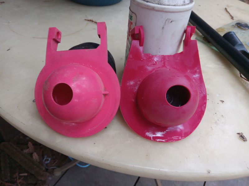

We have a standard flush toilet in the cabin, goes to a holding tank I pay to have pumped. I noticed it filling up more quickly and sure enough the toilet tank was leaking. Fill it up, turn off the water, next morning the tank is empty. I pulled the flapper, red rubber one, did have some sediment on it. The pipe it rests on is fine, smooth with no detectable nicks or anything. Cleaned the flapper, still leaked. Went and bought a new flapper, fit perfectly, still leaking. Only thing out of the ordinary is I have the fill valve set lower so it uses less water to flush. Does the toilet depend on an amount of water to hold the flapper down? My next step is to put a weight on the flatter to see if that helps seal it. It's the only place water can leak into the bowl, right?

# Posted: 28 Oct 2022 11:52am - Edited by: paulz

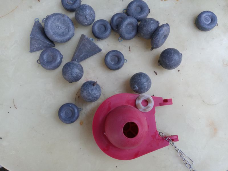

The new flapper is taylor made to put weight inside. I've gone from a smaller weight, still leaked, to piling weights on top, no leak. Right now one big weight inside. Still testing.

No not sure, the one I bought said something like 'fits most toilets with 3" opening'. Looks the same and fits perfectly.
But, despite repeated attempts I haven't been able to get it to seal. The good news is yesterday I cleaned the old one again and put a weight in it, still holding this morning with only an inch of water over it.

The good news is my old flapper, super cleaned and with a fishing weight inside, held last night and today, so there is hope on the horizon. I'm still turning the valve off after the once a day flush, leaving just enough tank water to test the flapper. As I mentioned, all our flush goes into a 500 gallon holding tank, which luckily has only been costing me $100 to have pumped. But having water run straight from the well tank into the holding tank is like, well, flushing money down the toilet.
