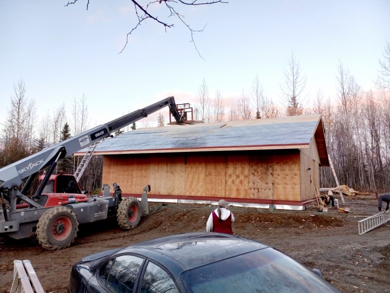

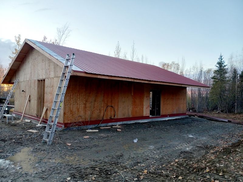

Any installation tips is good. A picture of the house while installing the metal roofing. Thanks for the help folks
West side
West side
Other side
Other side
