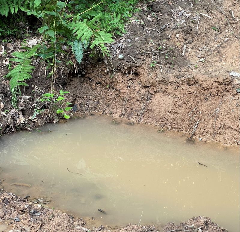

I found a full time spring on my property. It's only a trickle so far but I plan on using Sgt Rock to dig it down further to see if the flow improves. I had a booked marked web site youtube with a spring developing guy who did remote stuff for folks but I can't find it now. He said you got to put in clay so far above to keep critter poop out.

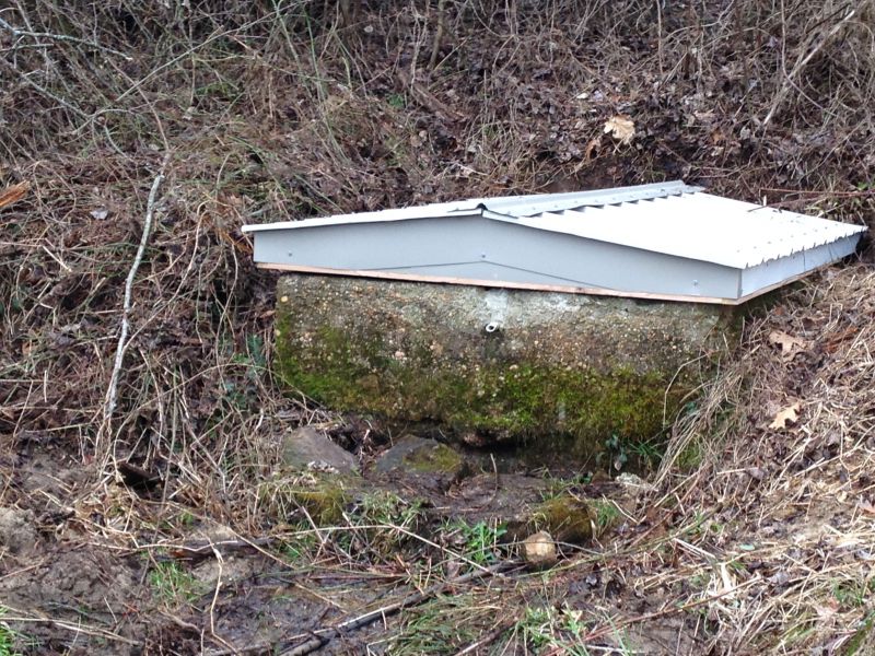

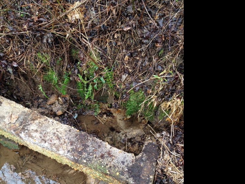

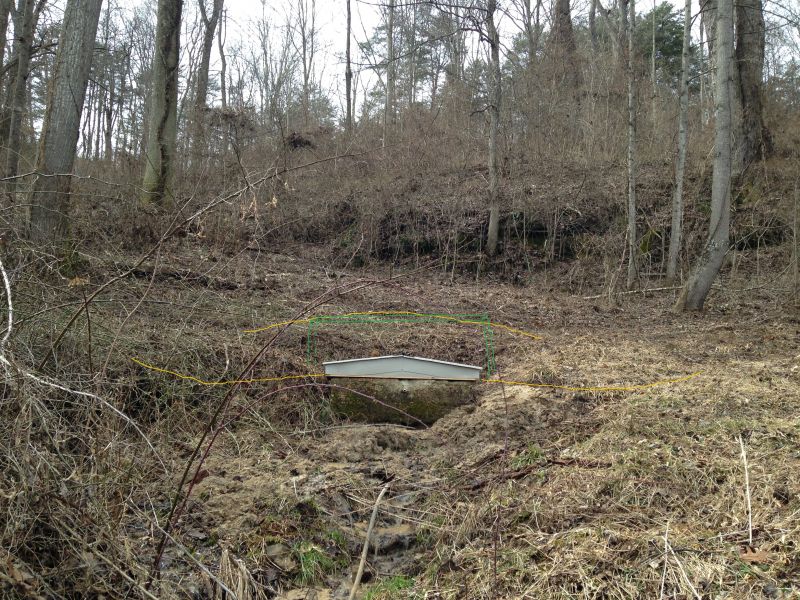

# Posted: 7 Nov 2022 11:14am
The spring had a U-shaped concrete structure in front of it, designed to trap the sand from the flow, not unlike a more modern spring box. I covered it with a roof, to protect it from the weather. However, even though the box collected and held the water it proved to be not as clean as I wanted. I opened up the end and let the water flow through the concrete structure. Then, up into the hill-side and rock, I noticed the water was trickling out of the rock (not unlike a small cave). So, to get the cleanest water I could, I took a plastic dish pan and put a hole in it to accept a 1 1/2 inch pipe. The pan sits up in the cave area and collects only the water dripping out of the rock, before it makes contact with the ground. The pipe is then extended out of the box for convenience where I can set a jug under the flow and cover the end of the pipe with pantyhose while I collect the water. Attached is pictures of the lay of the land and a close up of where the cave is along with others. Most people would be more likely in need of a gravel bed and plastic spring box, unlike here.
Unfortunately, I don't have a pic of the dish pan and pipe I installed.

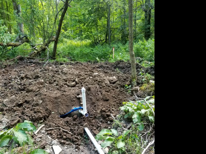

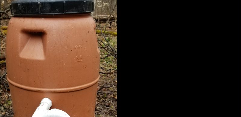

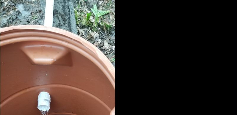

# Posted: 7 Nov 2022 07:40pm
Kind of hard to tell in these pics. The blue thing is a piece of heavy poly that covers the gravel bed that helps collect the water. I dug a surface water drainage swale around the whole thing so no surface water will get in. Once you have the water in a pipe it's easy to deal with.
Brown barrel is my "spring box/pump chamber. White pvc is the inlet. I have the Tee and 90* for over flow protection incase anything backs up further down. The bottom of the barrel has two 1in bulkhead fittings. One for an overflow and one for my pump suction. The one with all the holes is the suction and the solid pipe that's open ended is the overflow.
I would be suprised if I have $200 into this setup.
After the spring box I use a 1/2hp jet pump to pump it up 60+ft to a IBC tote on a hill above our site. When the spring is really flowing I cant pump enough to get the water level to drop in the spring box. I fill a 275gal ibc tote in 35min.

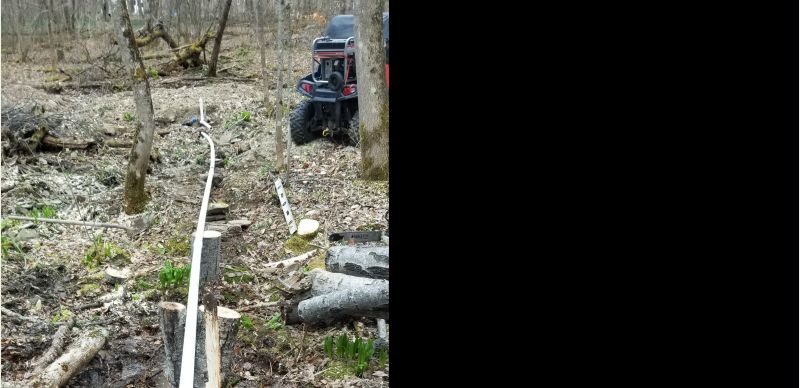

My water comes from a spring on my mountain. It flows all summer until freeze up happens.
I dug down and put in a 1000 water tank that the spring flows into from the top. The bottom has a 1 inch water pipe coming out. It's all gravity fed to me and I get about 80psi of head pressure. I actually have to turn the shut off valve about 1/4 close to manage the pressure.
In the picture you can see the mountain right above the moose. You can also see the black pipe I just lay on top of the ground to feed the cabin. I get so much snow that the pipe never freezes. It still amazes me that my water is so clean, plentiful and easy to obtain. One good thing about the mountains.

My problems come from falling trees. I have had more than a few branches poke holes in the pipe. I have cut out the line a few times now. I also get a few burst fitting on the line when the temp freezes, but snow dosen't yet cover it all up to insulate.
I have dropped tons of trees down, but there are just to many to do. I have to strike a balance between cutting down all the trees and then dealing with all the slash or select cutting to keep a path and remove dangerous trees.
