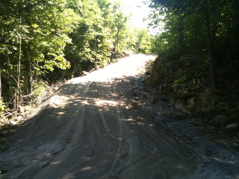

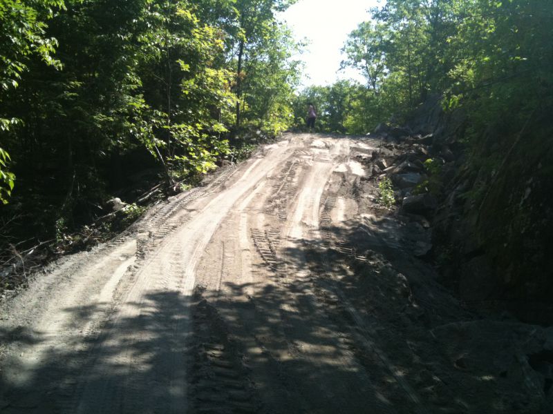

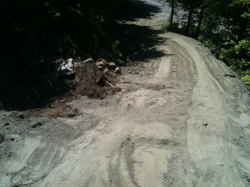

I had a driveway built using screenings, I KNOW its not what should of been used but thats what the contractor advised to use so i went with it.. Its ok now but likely have problems after each years thaw/spring.
Is it worth to get 1-2 trucks loads of 3/4 crush stone and place it overtop of the screenings ? Im thinking of putting some on the bottom before the hill up .. and also on the top clearing..
Am i wasting my money? After speaking with engineers, 2-3 minus should of been used as the base then 3/4 / 5/8 crushed should of be placed on top and compacted.. O WELL ... its done and I have to live with it ..lol
What ya think landing looking up to clearing

# Posted: 17 Jun 2011 10:37am
I had 8 loads of 5/8 minus, this stuff will set in and pack like concrete. You could of had larger crushed rock first, then add the 5/8 minis to keep wate4r and freezing under control. Looks like a decent ditch, add large rocks in the ditch to slow down water flow to keep it from washing out during heavy spring and fall rains. Step it like a fishladder. Real troubled areas may require a culvert under the road to move some water from the inside to the outside. That is all loose looking, it wont stabilize till its all packed in naturally
spee
# Posted: 17 Jun 2011 10:46am
it was recently graded( same day as the pics ) so I hope some time and some sun will tighten it up.
Do you think its worth adding 5/8 minus on top of the screenings ? or save the cash and use it for now and if comes a time when serious building is required... dig out the existing material and thrown down proper stuff?

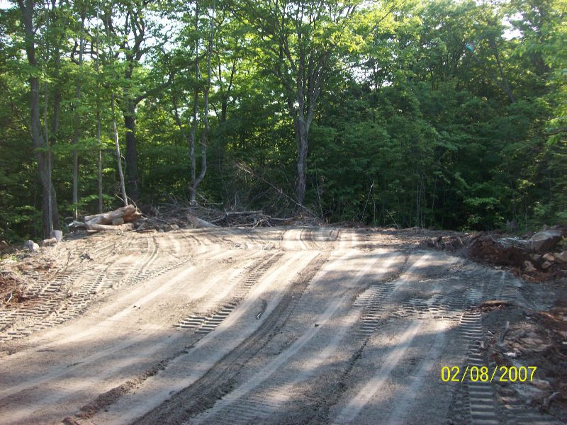

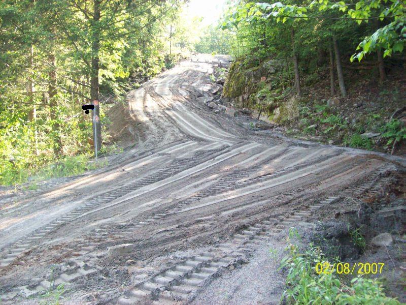

# Posted: 20 Jun 2011 11:05am
It's not clear what problem you are trying to solve. Your photos have 2007 on them. Has it been 4 years or is the date wrong?
spee
# Posted: 20 Jun 2011 11:14am
Friends camera has the wrong date! these are from 1 week ago.

Quoting: spee I had a driveway built using screenings, I KNOW its not what should of been used but thats what the contractor advised to use so i went with it.. 1st question, what's under the 'sceenings'? (looks like a lot of sand like material)
2nd, what kind of contractor?

It surprises me that someone who could such a nice job would advise the use of screenings, if screenings were the wrong material to top it with. Are you sure it doesn't have proper material under the screenings?
You do have a grade.....maybe consider to put some gentle swales in so the water can't get up to speed.

I hear you on the dust though, I would try something like "rolling" it to pack it down.
Have you expressed these concerns to the contractor who made the driveway?

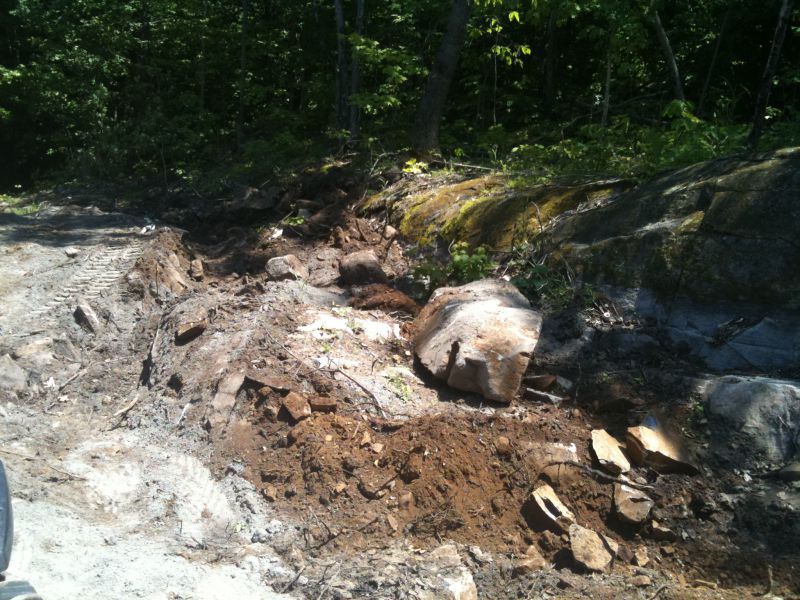

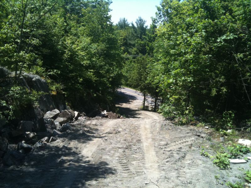

spee
# Posted: 20 Jun 2011 12:03pm
Screenings were used from the soil up... no bigger stones on the bottom..All screenings
Contractor that builds roads and landscaping in the area...used an mini excavator.
I have spoke with him but hes telling me just to use it for now and enjoy it and take it from there.. It seems unfinished to me... the ditch along the side is uneven..( some areas have rocks some dont) the back of the clearing is not smoothened out ....high point half way up the driveway that causes traction issues.

# Posted: 21 Jun 2011 09:15am
Quoting: spee I have spoke with him but hes telling me just to use it for now and enjoy it and take it from there.. If it were me, I'd be havin' another chat with him. Especially about 'taking it from there' Seems a gully washer would undermine the bend in that road, even if you put the best of stuff on top. But he's the road builder.... Then I'd talk to a couple more road builders, and get 'em out to see and advise. Then, if they advise to the contrary, I'd find a good (ptui) attorney........ I sure wouldn't soak any more dinero into it before that.
