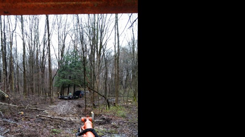

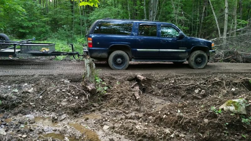

When I did mine I actualy layed down 3-6in logs, dug a trench on each side and put the dirt covering the logs then layed the fabric down. I had a 20klb stone truck over it in 2 months.

# Posted: 11 May 2023 08:27am
These two pics where of the swamp my driveway runs through. There a few months appart. Corduroy roads do work, they spread the load on soft ground. In my situation I dug trenches that could drain away.
