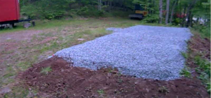

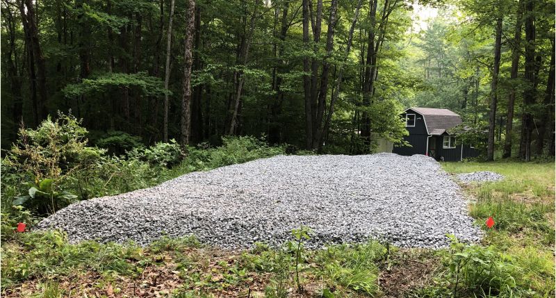

# Posted: 17 Jul 2023 01:14pm
Thanks for your replies.
I am not at the location this week but here are two shots. (One is from a remote camera, so it's lousy quality).
# Posted: 17 Jul 2023 05:50pm
Looking at those, I'd have them just drop it on the gravel pad. Make sure to have a rain gutter at least on the "up hill" side and route the water from the down spouts away from the pad.
# Posted: 18 Jul 2023 08:34am
Pad looks fine to me. I may just tamp it tight and drop the building on it. Looks plenty high and well drained.
