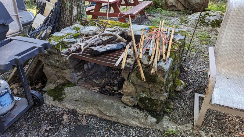

We have this old stone fireplace / grill behind our cabin, built many years ago, long before we moved in. Probably 60-100 years old.
Anyway, although I have cooked on it it's a pretty inefficient grill, and while it's decent as a fireplace it's not in a great location for it (chosen, no doubt, to make use of the rock in the middle of the patio). But it's in a good location for cooking, so lately I've been putting the grill in front of it.
I don't want to remove it, it's got some history, so I'm thinking of how to use it better. I do want propane for the convenience. A tabletop grill set on top of it would work, but nobody seems to make a decent size tabletop grill, they're all small portables. Grills made for built-in installation are all too large and too expensive. Another option is to build some pipe burners (which I've done before, for a larger oil tank cooker) to set under the existing grate with some lava rocks, and build a stainless sheet metal pan and cover.
A decent size portable would be my first choice, as I could still use it as a fireplace if I want to... or I could buy a conventional grill (or repair my old one) and hack off the legs and add handles.
Anybody know of a decent size tabletop grill? Or have some other ideas?
Excuse all the junk on top of it in the picture, I'm in the middle of several projects and as everybody knows flat surfaces attract junk.

Looks like a good fireplace. I like cooking over a open fire but I see the problem with the coals being too low so a large fire base would be needed to use for cooking.
I think if you drilled some pins inside the walls and placed a metal plate on them to raise the coal bed up close to the grill would help. a quick easy-to-use and remove when you just want to sit around the campfire times.

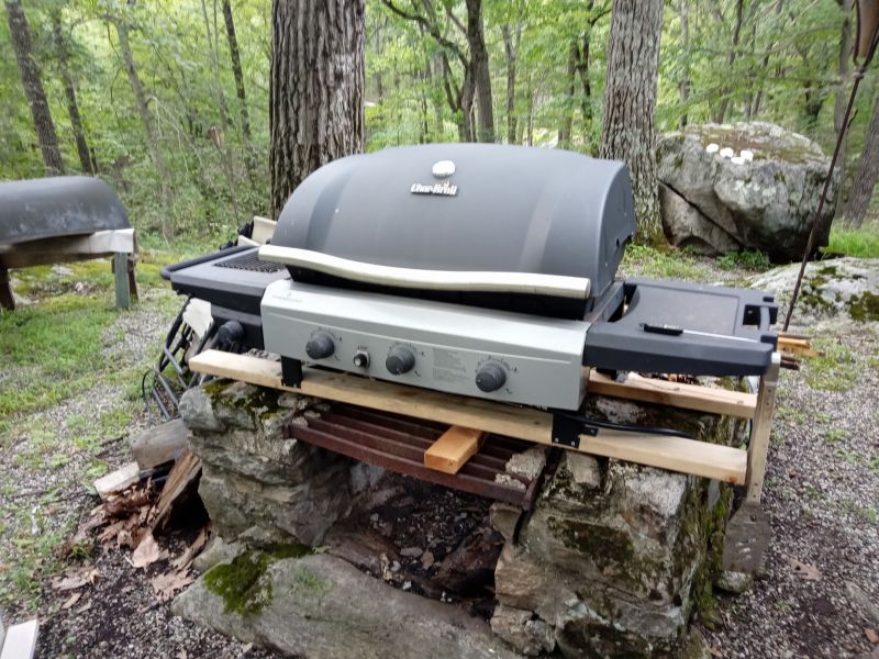

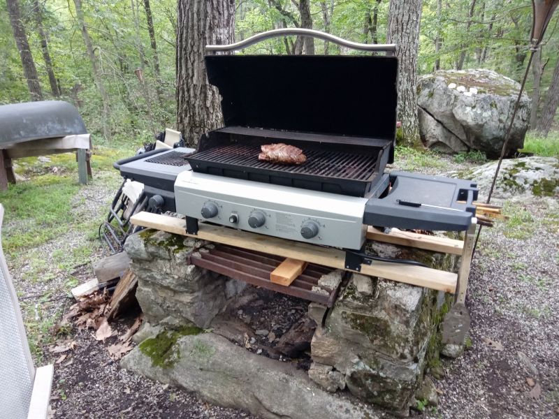

# Posted: 4 Sep 2023 01:43pm
This is what I ended up with, at least for now. Crude, but I can still use it as a fireplace when I want to.
# Posted: 4 Sep 2023 02:29pm
MkI versions are often a bit rough to prove proof of concept
