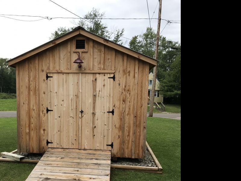

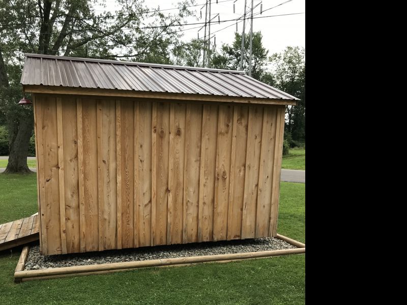

Hello everyone first time posting here. I purchased an 10x12 Amish Shed last fall. I now want to seal/waterproof it and I really don’t know what to use. I would like something that would make it easier to keep clean. Maybe a semi gloss? I want to keep its natural color but could go darker if necessary. My main goal is to seal/waterproof it. Does anyone have anything they would recommend to use? I’ve got so many different opinions I’m just clueless. Sherwin Williams recommended this.. https://www.sherwin-williams.com/homeowners/products/woodscapes-exterior-polyurethane -semitransparent-house-stain?itemCatentryId=19105

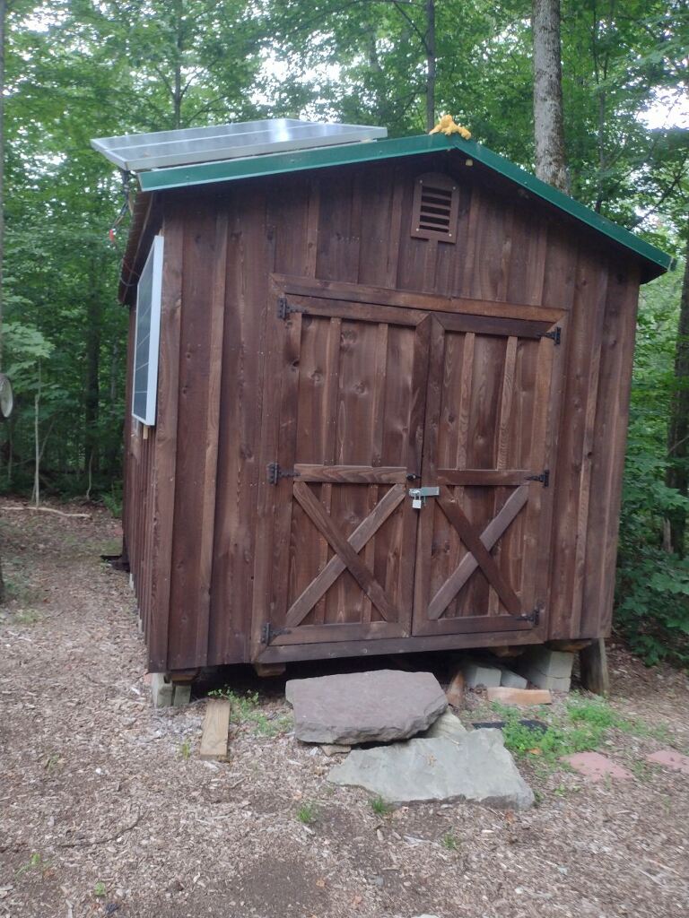

I did this shed with oil based TWP 4yrs ago and it looks the same.
Since its rough cut wood you may need to come back in about 1yr to cawlk the battens and other cracks but that's not due to the stain it's due to the wood drying. My 10x14 shed took about 3.5gal of that 1500 series stain.

That looks like my shed as it looks like it was made with Hemlock? Which TWP stain did you use? Like I said prior I don’t want to darken mine too much. Thanks again for your help!
# Posted: 21 Aug 2023 07:36pm
That was TWP 1500 series dark oak. It's just about as dark of a stain as they sell. The darker the stain the less UV graying you will get.
hanginghelmet
# Posted: 21 Aug 2023 08:48pm
Well you have me leaning that way. Your shed looks like it came out great
