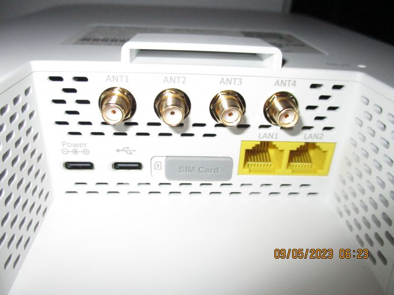

The T Mobil sales rep got a couple of things wrong, but it's all good. 'Received the gateway today, 2 days early. And it's the new model TMO-G4AR by Arcadyan, with the 4 external antenna connections. I'll be back to the cabin on Friday and we'll see about signal reception. But now at least I can easily add a 4X4 external antenna if needed. BTW, Starlink doesn't have an app that works with my rather basic LG 10 phone. Fortunately, T Mobil's app is compatible.

that's the model i linked to above from their site. Good news as it gives you the option, if needed or wanted, to add the antenna - still cheaper than Starlink i suspect

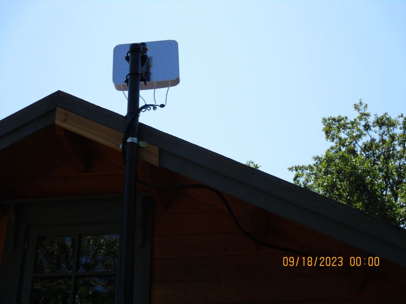

'Installed the Waveform 4X4 MIMO antenna to the T Mobil 5G gateway today. Speeds increased quite a bit, I'm now up to an average of 200 down and 9 up. I think this approaches typical Star Link performance, so I'm quite happy with this setup (actually better than my AT&T home service).![Waveform 4X4 MIMO antenna Waveform 4X4 MIMO antenna](https://www.small-cabin.com/forum/shared_files/uploaded/11848/163851_1.jpg) Waveform 4X4 MIMO antenna

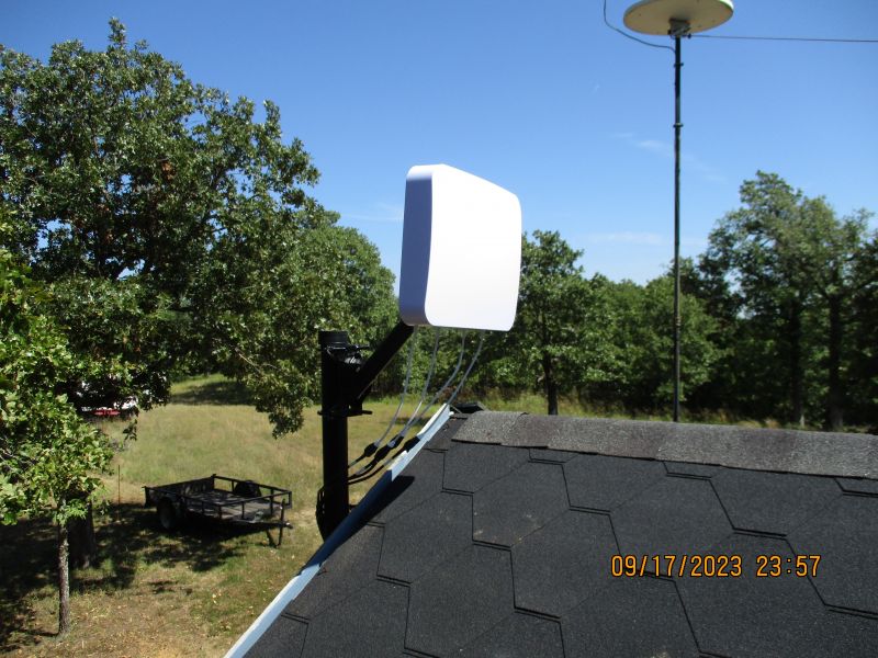

Another photo.![Waveform 4X4 MIMO antenna Waveform 4X4 MIMO antenna](https://www.small-cabin.com/forum/shared_files/uploaded/11848/163852_1.jpg) Waveform 4X4 MIMO antenna

I'd say 200 down and 9 up is damn good! I assume ping rate, SNR etc are all good as well. Nice solution.
