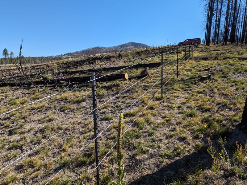

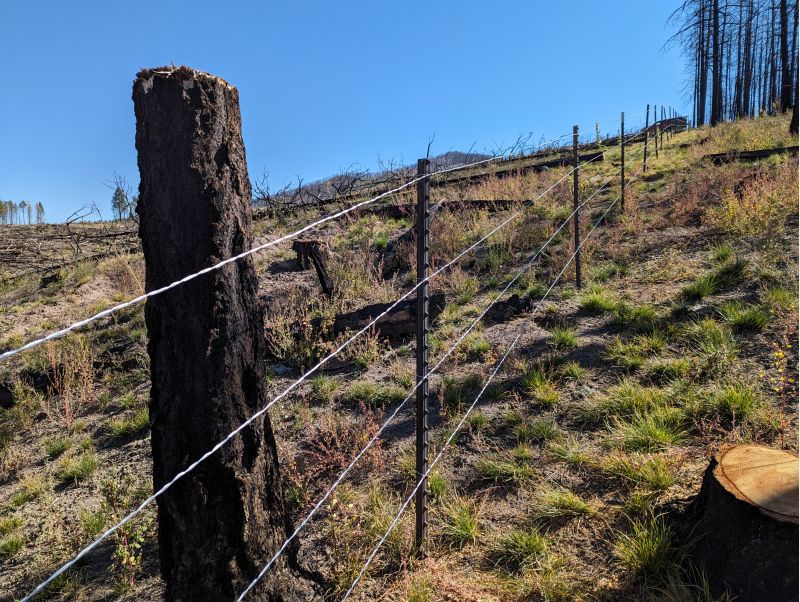

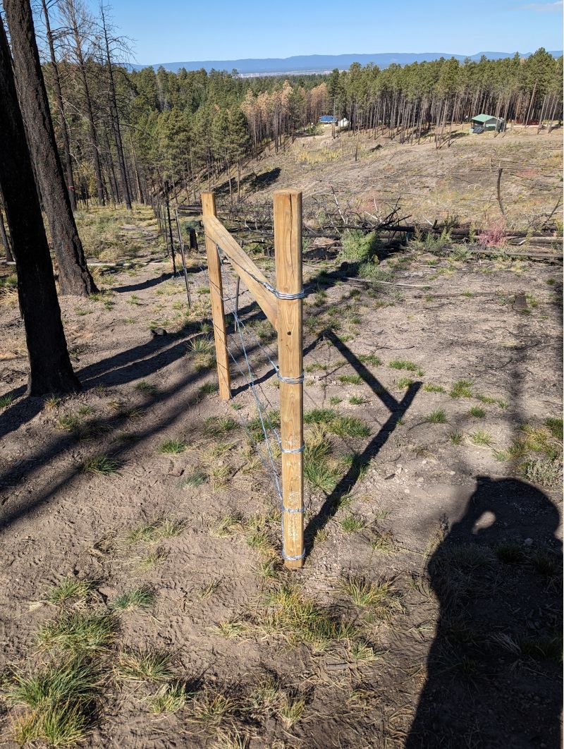

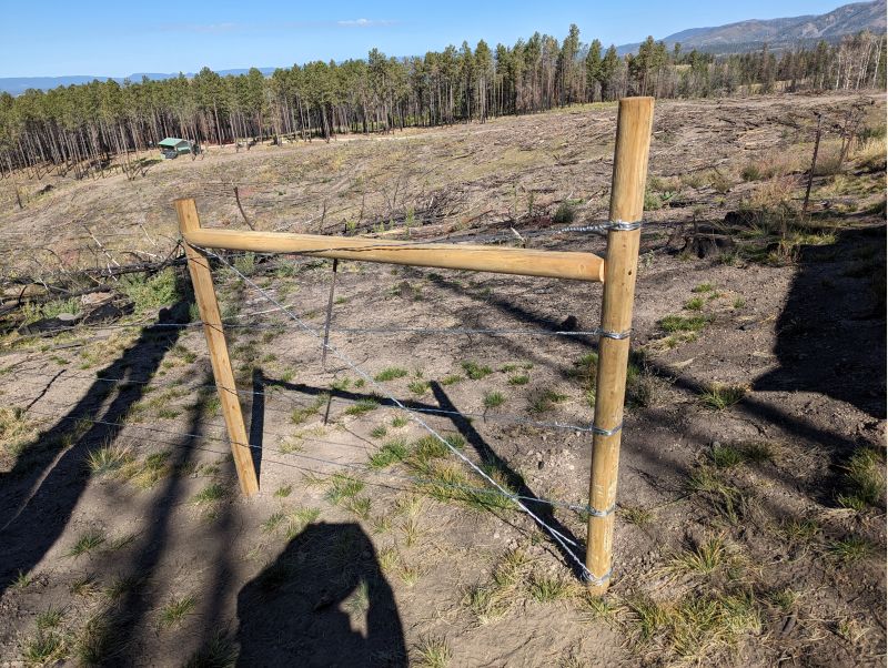

I finished my fence project which I mentioned in a hi-jack of another topic. A 640 foot length of wire fencing on a medium to steep slope between us and the national forest. There was a wildfire, mainly in the national forest, a couple of years ago that burned across a corner of our family getaway land. The barbed wire looses its strength after fire heat. The NF sells grazing permits and I would rather keep the cattle in the forest.
I re-used most of the t-posts and rebuilt h-braces at the ends and low/high points. Four strands of barbless 12.5 gauge wire to be kinder to the wildlife. The cattle seem to be stopped by the visual of the wire strands.
The pictures were taken from the NF side of the boundary. We logged all the burnt trees which were run thru the sawmill. Still have some trash trees on the ground that should be masticated. I'm trying for an NRCS grant to cost-share that. The adjacent NF is all blackened standing dead and falling over trees. You can see we were close to loosing the cabin but we were lucky.
There will be a steel gate at the h-brace seen, but that is another project earmarked for spring '24
East
East
East w truck
East w truck
Northerly
Northerly
West
West

ICC, work looks great. What was the distance between T post? I have all barbed stuff, buddy put one up in Wyoming,t hey are not allowed to used barbed wire on the lower run, pronghorns cant jump, never knew that, so they can safely crawl under it. Its a state law.

12 feet

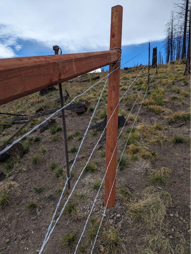

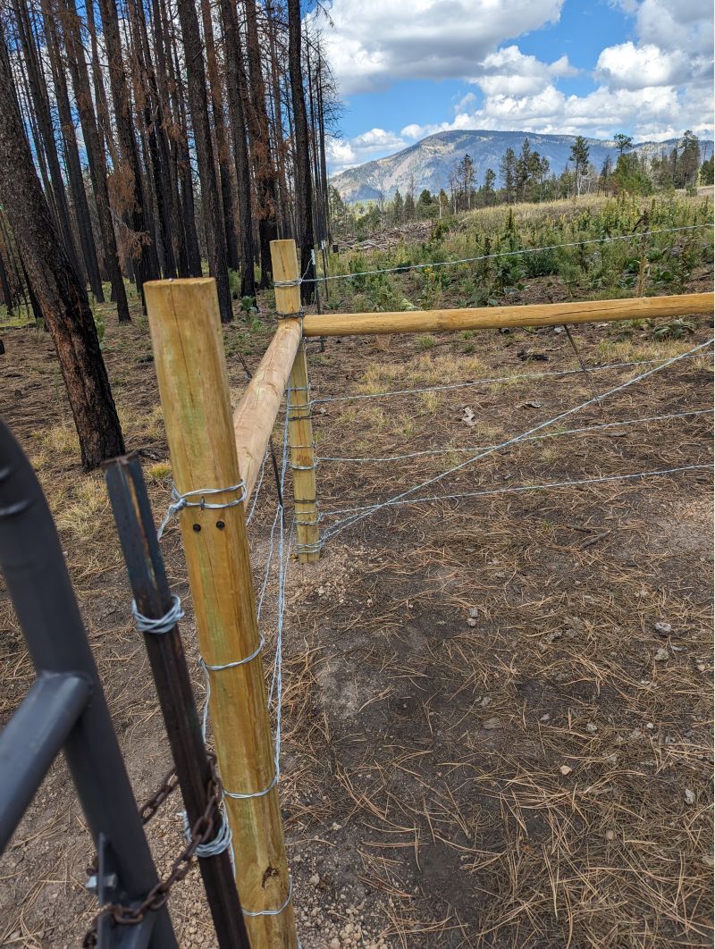

Another h-brace from the bottom end of the south line section (mentioned above)...
S midline
S midline

Another corner near the cabin. Burnt standing dead in NF to left (west) of h-brace and fence/gate. Gate to NF road, my cabin lot to right. Cousins lot behind (north of) the h-brace straight ahead. Her cabin was destroyed. The plan is to build a new 16 x 30 next year.
NW corner
NW corner

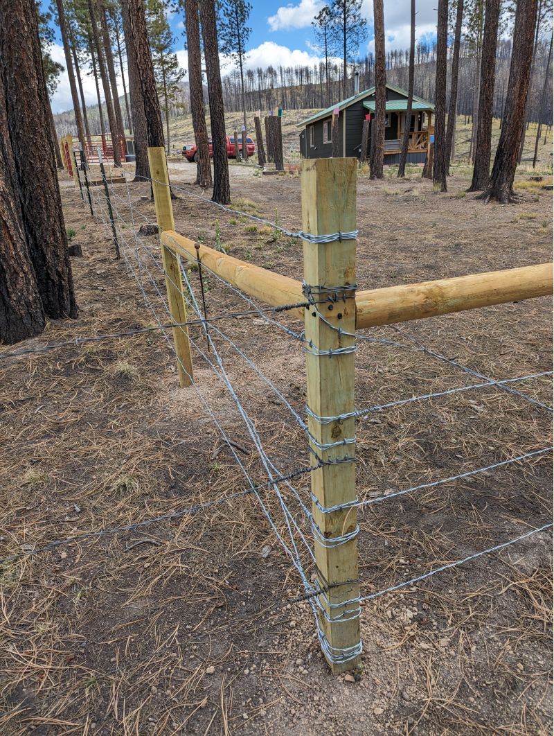

# Posted: 30 Sep 2023 08:15pm
Same corner as above looking towards my cabin. I use rebar for twitch sticks.
NW to east
NW to east

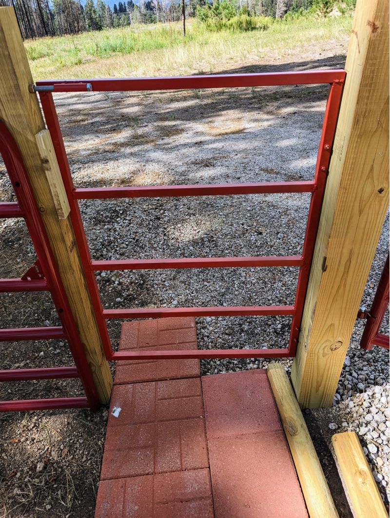

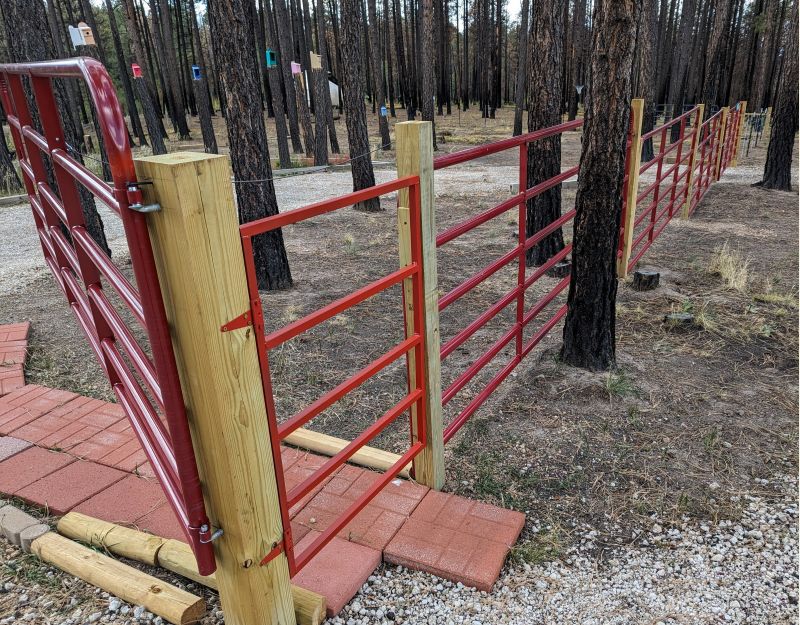

Instead of an all wire fence line I used farm or ranch gates (name depends on geographic location) on the front line of my cabin. PT posts set 46" deep with some gates fixed in place and others hinged as gates. I made the people size gate from 1" square tubing with my semi-hidden shop made sliding bolt on the inside
1g
1g
Slide bolt
Slide bolt

Another nice advantage to leaving high stumps is the easy of pulling them out as it rots a bit, hook a nice strap to them and with some digging around the base, pulls out much easier. Hey, your screw in anchors for your gate (red gate), turn top one so it points down, so gate cant be just lifted off hinge. Ever see those Speeco gate latches, a push and the gate closes and latches and can be opened either way.

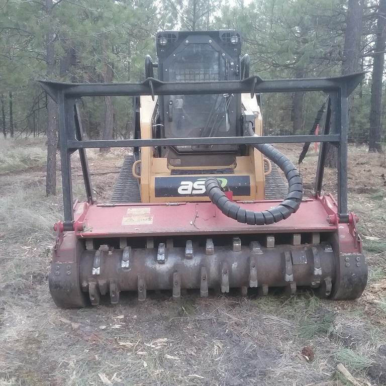

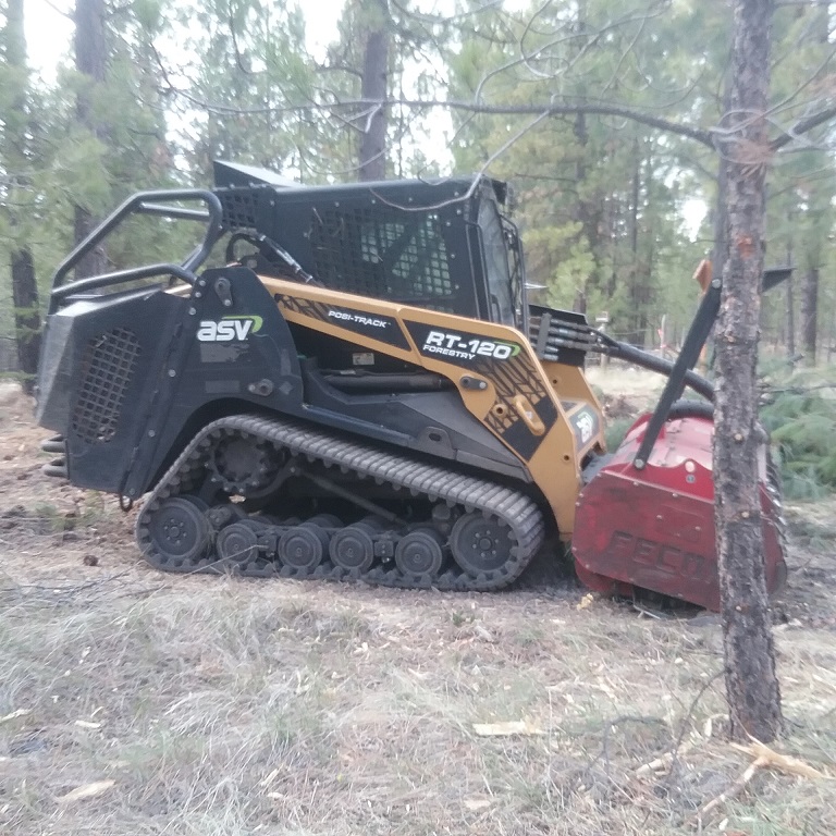

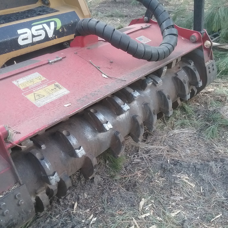

Treating forest here went for $1,260 per acre, get a guy with an ASV 120HP skid steer and add the Fencon. Ask the DNR guys who work out the 75/25 split, they will have a list of people. They wont steer you to a particular one, but they work with them and just ask them if this was you, who would you hire.
This is the hot ticket up here.
https://theforestrypros.com/tools/fecon-mulcher-review/

@toyota_mdt_tech, Thanks very much for the tip on looking at the valve lash. Also thanks for the reminder about the Jakes fence wire tighteners. I knew about them but had forgotten. I've used a self-made tightened "doohickey" using short pieces of small EMT, twisting them in with a steel rod, but the Jakes look nicer.
You have a sharp eye for detail. I wondered if anyone would say anything about the gate hinge top anchors. I had a helper that day and she measured and drilled holes for the screw in pins. It was easier to leave them that way. Plus I don't go out of my way anymore to make things overly difficult for theves. Our cabins are very remote. A burglar would have lots of time alone. We have been fortunate with only one break in 22 years. That was about 15 years ago. They took their sweet time and eventually broke through the hardened deadlocked doors. Not only did they selectively steal a lot of stuff but the cabin and pole barn doors and frames were trashed and required complete replacements. As for the then locked with properly reversed gate top hinge pin, they removed the bolt in the clamp on hinge bracket and pulled the gate aside. And then drove over it. So I adjusted tactics and used simpler locks that remind the honest folks to keep out and make damages easier to repair if thieves come by again.

Nice skid-steer mounted mulcher!
